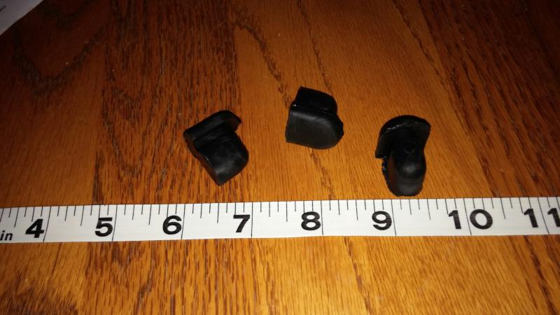

My gin pole is 78" from the very bottom tip to the top of the tube body (not including the cap). No drawings in the manual for this, so here's a couple pics. Actually, my only rebuke of the boat is the manual. It's a joke. The steps were written well enough, but Hunter needed to provide a few more illustrations, or even just some photos, especially since this was a starter boat. We've had cameras for most of the 20th century. And no page numbers - what up with that? Attention to the owners manual is dictated by the culture of the company, and that comes from the top. I'm not certain, but I'll bet the MacGregor family understood this. Good luck!
Edit: pole is 1" outside diameter
