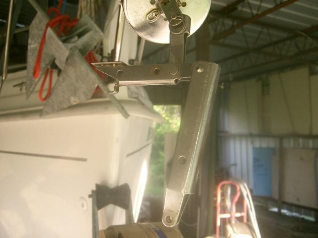

If you want an added tip that I've found to be a sweet addition for the guys who step their mast often I'd subtract the size a folding closure on the forestay length. A closure/quick release lever works like a charm to pull the rig into tension without having to over tighten the rig with a gin pole just to get a pin in it. Here's a pic of the closure/lever available at JSI and CSJohnson among others.

The hyfield-Johnson lever is an excellent idea if you do any trailering at all. I put one on my previous boat and would like one on the 260. Just be sure your sail luff is short enough to have the foil shortened by the 8" or so required for the lever to sit below the drum.
Mike it looks like from the picture that you are using the 14-206 model lever, is this correct ? the rating for it is only for a working load of 1000 lbs. The bigger lever 14-210 is rated at 1600 lbs but uses 5/16" pins. So if you have the bigger lever did you have to drill out the holes in the forestay and furler or can you use smaller pins in the bigger holes? The wire on the 260 is rated at 3300 lbs I believe, so these levers would really be the weakest link. I may switch to nicopress when I change the furler/forestay, I think a nicopress fitting is rated at 80% of wire strength, don't know about swagged fittings, look stronger.

My lever is a 206 that I've trimmed down to fit as low as possible. The pin in the base of the CDI was 1/4" pin and yes it'd be the weakest link at a conservative 2200lbs dbl shear strength. The 210 lever was almost 2" taller and used a 5/16 pin but I'd still need a 1/4" pin for the furler end. The load on the lever when the rig is properly tensioned is about 50% of its "working load" and about 30% of its "breaking load". Just slightly higher than an ideal 20% but within my comfort zone if the rig is properly tuned/maintained and isn't pushing solid objects like a low bridge or a tree limb;)
By the way the threaded swage fitting on the lower section of the forestay will fit down through the inside of the CDI pvc furler extrusion. I'd use a tag line to pull it through but it can happen with the fitting on. I still have the extrusion piece I trimmed off when I added my lever so I'll take a pic tonight and get a few measurements from it too.

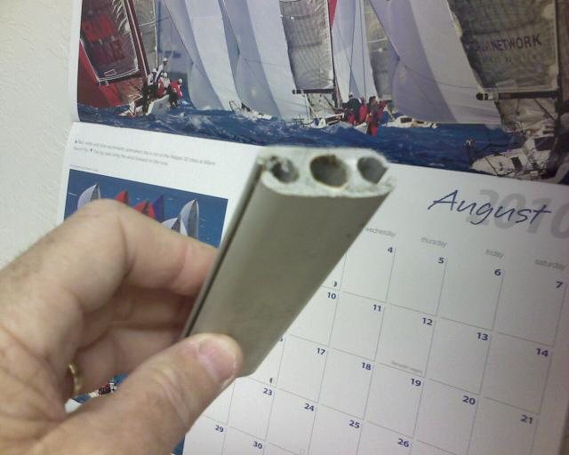

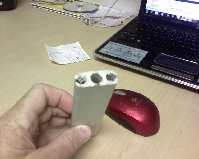

I haven't taken the drum off my CDI for its annual once over yet but will post pics next week. Here's a couple detail pics of the CDI extrusion. Center hole is 3/8". luff line track is about 11/32".
Have a great day. Mike

Mike, the 210 lever looks like the best option for the 260, I'll probably go with one of those when I buy the new furler.
thanks, Bob
