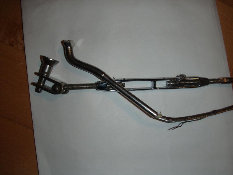

I measured my originnal forstay. 30 feet from the tip of the T-ball to the capture pin on the bottom.
So 29' 11.25" sounds right.
There will be adjustment room in the turn buckle as shown in the photo
