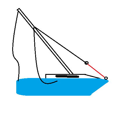

I was thinking about rigging up a forestay extension that would allow me to drop the mast just enough to cruise under the bridge (see attached image). This would allow me to not have to completely drop the mast and possibly even restep the mast solo. Obviously the boat would not be under sail or stored in this configuration.
Would this put too much stress on the forestay attachment points (on the mast and bow) or mast step?
Does anyone have any experience with this matter?

Since you will be motoring under the bridge the tension on the forstay shouldn't be any problem. You will, however, have an issue with side to side movement. Since the shrouds will be slack the only thing holding the side to side movement would be baby stays if you have them. The baby stays don't have much purchase on the mast so I wouldn't rely on them if you have to go under the bridge in rough water. You would be better off to add a taller mast crutch at the stern to hold the mast while you're navigating the bridges. Also, make sure that the rear stay is up and away from the propeller when you do this.

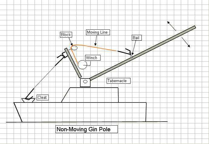

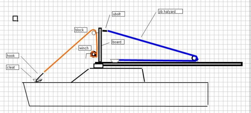

justsomeguy shows you a version of a moving gin pole with the foot of the pole on the mast itself.
sumner shows you a version of a fixed gin pole with the foot of the pole on the deck (in this case the tabernacle - as is ours). For you this would be the best set up I'm thinking.
I have attached a couple of concepts illustrating how the different setups might be used.
You will need baby stays for the mast I assure you. That is another subject unique to each boat. For ours I had to make a harness to run down to the side decks due to the wide pop top on a Venture.
