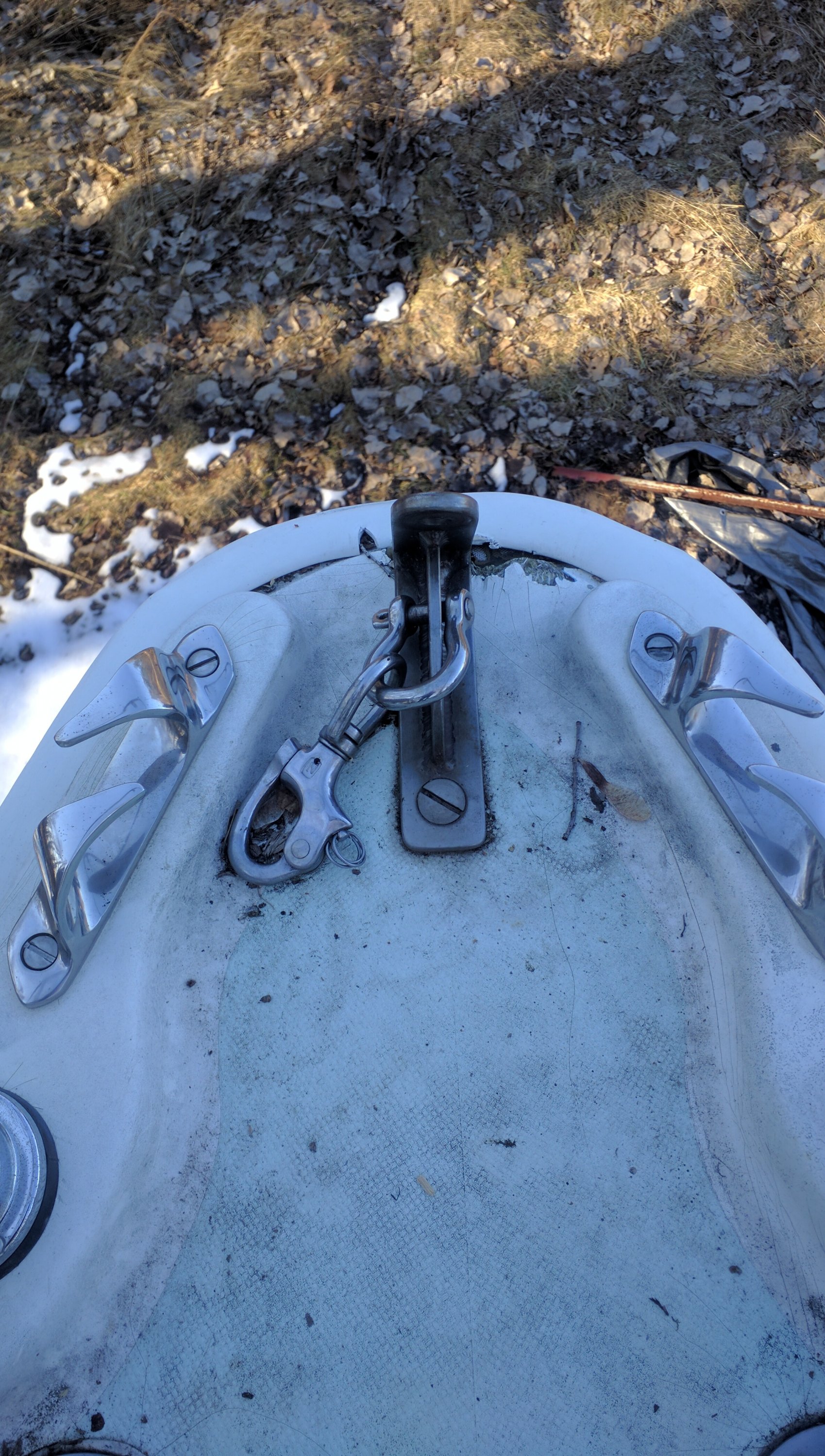

in this photo the forestay chainplate has two mounting points. The forward most is for the furler/forestay. On my boat there's a shackle and quick release hardware that doesn't connect to anything. all my photos of her in the yard before buying don't help me identify what it is there for. I was thinking maybe like a anchor chain keeper when stowed on the bow pulpit but i don't want to make assumptions.
I'm getting ready to put her in for the first time and i'm just auditing all hardware i have or don't have. This one i have and have no clue why. :)

well now i'm doubly confused. there's most certainly a roller furler here. maybe the hardware was left and truly unused?

if there's a furler on this the sail wouldn't be able to attach lower than the roller furling's rope "drum" (sorry, i don't know the term) without causing the furler to be useless - it'd just bind all up in the rope. Granted the sails were not on it when i purchased so maybe? i'm kinda grasping at straws how to translate theory to application here as i've never worked w/ a furler. It just came with the boat. Thanks!

Good possibility. Do you have an asymmetrical spinnaker? The tack line could be attached there. I use that hole to attach jack lines when sailing offshore.
Given the age of the boat, roller furling was added later and the tack shackle was just left there. If the boat was raced the roller furling drum could be removed and the jib tack would be attached there instead of to the furling drum.
If the furler works, don't worry about this shackle, but don't lose it, they ain't cheap.

Left over hardware. I added roller furling to my Cal a couple of years ago. The shackle for the hank on sail tack is still in place. Just like on yours. :)

The jib tack will attach to the fitting on the top of the furler drum, probably a welded on "hole", using a shackle. Since you have not rigged your boat yet you dont know how close to the drum the tack can get. If you find that when the jib is in the furler track and you raise it to the proper height that the tack is too far above the drum, it is possible that extra fitting was used to attach the tack to the drum. The prior owner may have just stored it where it is. Sort of an extender. Or, you may need that thing from the head to the jib halyard. Either way it might have been used if the jib luff is a bit too short.

Pearson didn't know the boat would be rigged with a furling system when they built the boat. If you had a forestay without a furling drum you attach the forestay to the forward hole and you would need a place to attach the tack of the sail. The would be the other hole.
And yes, use the forward hole which has more meat to wear on.
You may find when you bend on the jib that you want the foot of the sail to be higher for a variety of reasons. That shackle could be the PO's way of doing that. BTW, PO's are blamed for every problem a boat has around here. They are sorta like a SBO piñata.

The manufacturer put in a chainplate that allowed for hank-on headsail or roller furling headsail.
You could move the roller furler to the after hole and fly your asym from the forward one, if there is room.

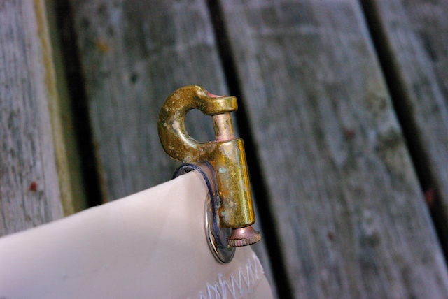

Your newly serviced sails, what does the luff of the jib look like? Are there hanks attached?
Looking like this.
Then you attach a wire stay from the front of the mast to the first hole (closest to bow) and attach the bottom of the jib (called the jib tack) to the other hole with a tack shackle.
