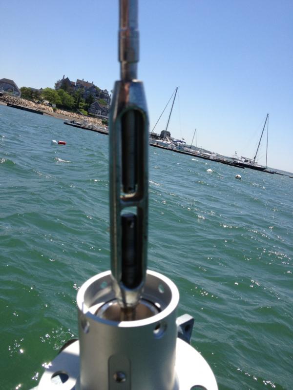

Recently got our Pearson 32 back in the water after an engine refit (5411 out, 3YM20 in) along with replacement of the fore stay and furler (Schaefer 1100). On the shakedown, after we departed the yard, noticed the rigging was pretty lose (side stays tight, fore and back stays noticeably slack). Fore stay was so loose, it could be seen to sway side to side. Needless to say, we didn't raise canvas, and motored to home port, where she's now on the hook. New engine worked really well!
So day after returning home, I went back to the boat on Sunday to adjust the rigging. I was able to get all side stays and shrouds similarly tight, and mast is centered. Back stay is also tight, and mast has maybe a 4-5 degree bend aft. My fore stay is now pretty much as tight as I can get it.
My question is this: with the furler reassembled, I can still deflect the stay ~5 degrees forward/aft is this normal?

I would say if looking at the furler drum assembly, there less than an inch movement forward and aft. Not quite sure how much that would translate to at the stay midpoint (sag). What i meant by the 5 degrees was the +/- movement observed in the drum, assuming a center line from the bow chain plate/shackle pin to the mast head. Does this make sense? And the fore stay turnbuckle is nearly maxed out (maybe 4 turns left?)
