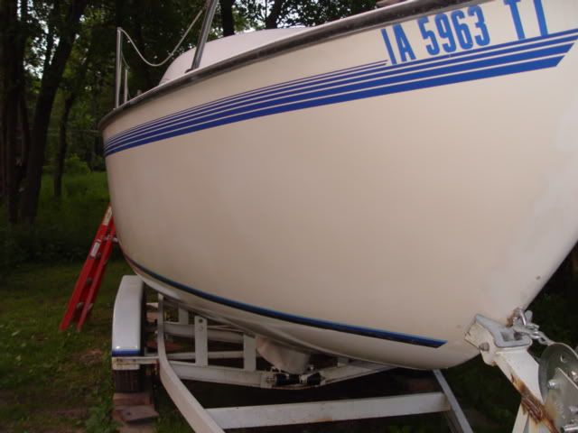

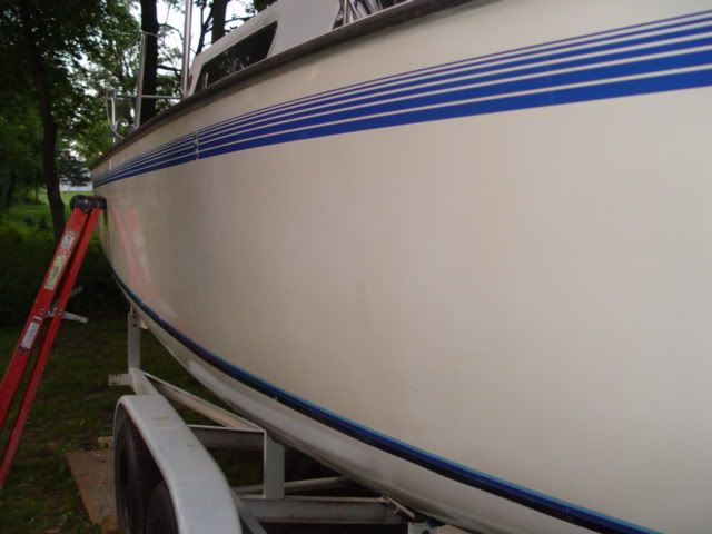

Reflections
Here are a couple of shots, the light was not good, but you can see reflection of the ladder in them.

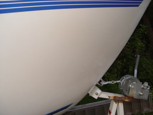

You can just see the winch a little in this one.
