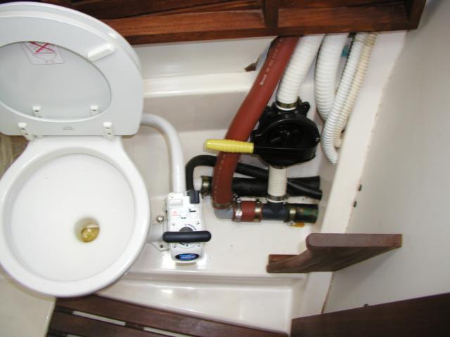

Hey, Ed.. My H-34 was set up from the factory with a Whale Gusher, hand powered diaphragm pump. The boat is rigged to always go to the tank which can be pumped overboard with the Whale through a vented loop and thru-hull, or it can be pumped out at a facility through the regular deck access. This setup works well except the calcium carbonate-like flakes from the tank will jam the vertically oriented discharge valve of the hand pump. It takes about a year to jam it. If my pump were oriented horizontally, I don’t think this would happen. Attached picture shows the plumbing mess that is more-or-less original. I haven't changed it because I can feel the valve beginning to plug and have time to rinse the thing out and open it and clear it. Nope, that is Bayou water in there and not what it looks like! The red industrial hose goes to the deck pump-out.

Flushing the pump with vinegar will help clear the mineral deposits. IIRC, you don't need a vented loop on the tank discharge line. The diaphragm pump acts as a check valve (since it has two check valves in it).

Ed, in the process of doing some re-plumbing I swapped out my Whale gusher for a macerator. Just ask and the hand pump will be on its way to you. Same pump as shown in post #5.

Thanks for the offer Scott. That is Claude's boat and from the picture it appears hat the pump is also the valve. Is that the case? At any rate I will e-mail you with my thinking on the subject and for your macerator reasoning.
10,103
I have found that nothing except hydrochloric acid will dissolve the kidney stones..I took samples home and tried several different things to try to dissolve that stuff. I do the vinegar flush and it reduces formation, but doesn't stop it completely.
Ed, you are right no Y valve needed but the head always goes to the tank first. I figured that since yours is that way already, it might be easier to Tee into the pump out line and put a pump in there.. I haven't put in a macerator because I figure the kidney stones from the tank would really challenge its longevity.

Distilled white vinegar, which is considerably more acidic than cider vinegar, will dissolve sea water minerals and urine crystals, but it's not practical for use in a tank discharge line because it needs to be used undiluted and about once a week to be effective. And while repeated "doses" of distilled white vinegar will eventually dissolve a heavy buildup, it's best used to prevent it.
As for whether a loop is necessary...your logic MIGHT be ok on a cat or powerboat that doesn't heel, but heeling changes the water on a monohull. Wind or sea conditions that cause a boat to heel even a few degrees can put a toilet bowl that's only slightly above waterline when the boat is at rest slightly below it... something that's sunk boats left with thru-hulls open in their slips. Sailing with the rails in the water can put the bowl--and the tank--WAY below the waterline. Which is why it's usually necessary to put vented loops several feet above the resting waterline to achieve the required 6-8" above waterline at any angle of heel.
So if you want to remove the loop (which could cause your boat to flunk an insurance survey), the pump should be moved to a location high enough above the tank to meet that requirement.
