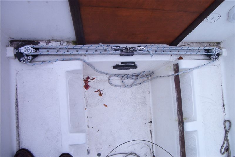

General traveler layout - for David
David: Here's the traveler on my H23. The track and car are stock. The end sheaves and controls are a matched pair, port and starboard. The Harken sheaves shackled to the car are singles with beckets. A single Wichard bow shackle with captive pin connects both sheaves to the car with enough room left over for the snap shackle on the bottom of the mainsheet tackle (not shown). Snap shackles on both ends make removing the mainsheet tackle from the boom a ...snap! (sorry) There's just one control line, like on a Hobie cat. It's 3/8 Sta-Set about 35 feet long. Yes that's correct...35 ft. The tackle is three-part, plus the slack in the middle. I need to be able to trim from the coaming if necessary. The line runs from the becket of the port car sheave, through the entire tackle on that side, across to the starboard side with plenty of slack, back through the tackle on that side and eventually tied off on the becket of the starboar sheave. I used a buntline hitch at each becket because it takes up very little room. Any book of knots should have a picture if you don't know how to tie one. All in all, this wasn't difficult. The hardest part was masking the track while recaulking to keep everything clean. Make sure not to caulk the two drain holes between the traveler and the cabin bulkhead...they're pretty small to begin with. You'll also need four new bolts for the end controls. I can't remember the size (I think they were 1/4-20) but they were flat-head and 1/2 longer than the old ones. I also posted close-ups of the car and the end control on the Photo Forum in case you need more detail. I hope this helps. Peter H23 "Raven"
