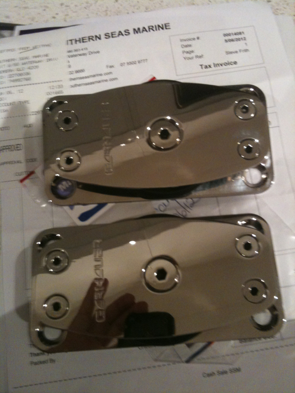

The blocks aren't shown on their website so I sent these 2 photos to the agent in Australia
Luckily these blocks have a 10 year warranty so it only cost me postage to get 2 new ones :)

Steve,
Thanks for the info and photos. I'll give them a call and see how it goes.
