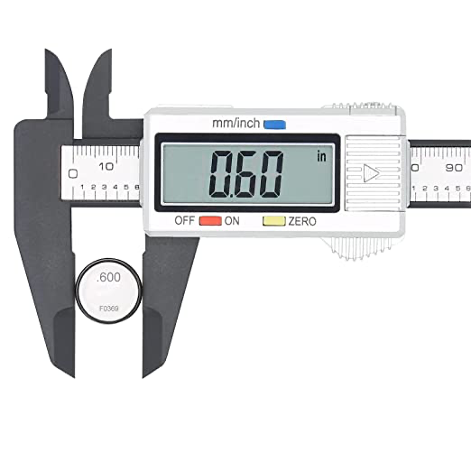

Hi SDS3.
  1. (fact) what is the size (diameter) of the standard Hunter shaft on this boat? Can not find it in documentation.
    1. That is what calipers are for. To help you measure your shaft when the boat documentation is weak. Even a cheap tool from Amazon will serve the purpose if it is for a zinc replacement. 1681838240215.png
    2. You might try the experimental approach. Buy a 3/4" and a 1" zinc returning the one that is the wrong size.

Hi SDS3.
    1. That is what calipers are for. To help you measure your shaft when the boat documentation is weak. Even a cheap tool from Amazon will serve the purpose if it is for a zinc replacement. View attachment 214745
