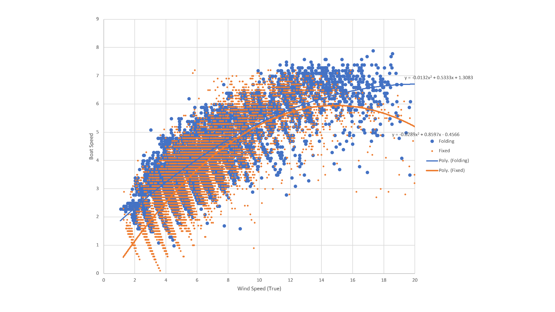

I’ve done that with my Flex-O-Fold.
Blue dots are boatspeed vs wind speed with the Flex-o-fold. Orange dots are the original 3 blade fixed prop. At low wind speed the folding prop is almost a knot faster. They converge as the wind builds, then the folding prop pulls ahead again as the wind builds and the fixed prop was causing the rudder stalls.

David, was the prop free to turn or locked when the test was done?

The fixed prop was always left in neutral as Yanmar recommends. With the folding prop we shift into reverse briefly after shutting down to fold the prop, then back into neutral.
