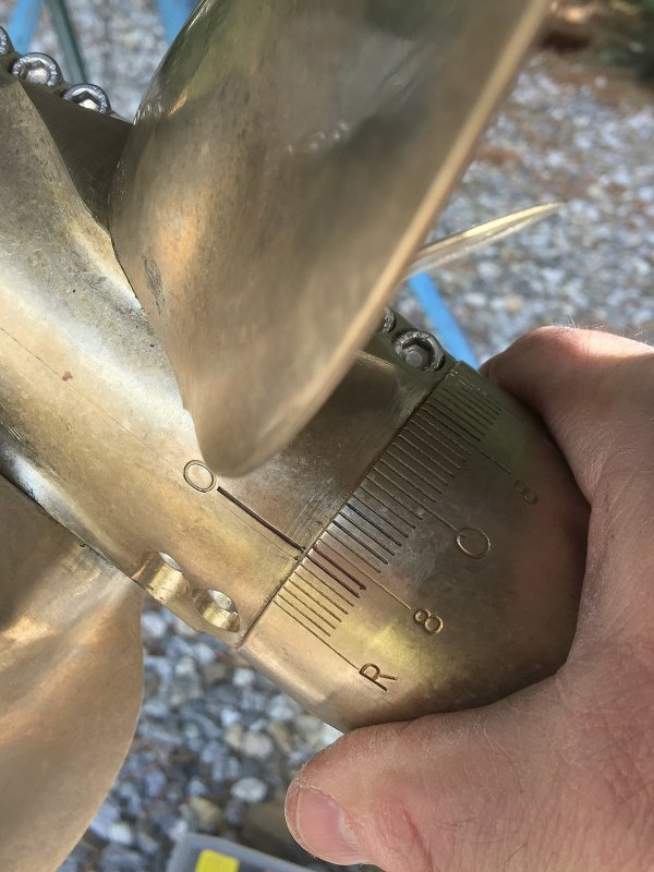

This time I chose the J-Prop which is a very well & creatively engineered feathering prop. In the running were Max Prop, Variprofile and the J-Prop. In the end the J-Prop won out. While not hugely popular in the US they are very popular in Europe and Beta USA (Stanley) is now the US importer & distributor. Stanley was surely a part of my decision to bite the bullet on the J-Prop as he is one of the most upstanding guys in the industry. In the end the features and engineering of the J-Prop really called to me.
I knew of them because I had rebuilt/regreased one for a customer a few years ago and was thoroughly impressed with it. I found no unusual wear and it really only needed and injection of grease but I was so used to tearing down Max Props to service them that I fully disassembled, cleansed and re-greased it.
Like many feathering props you need to cut the shaft slightly. I used my old prop nuts as guides. Nothing beats going old school with a hack saw for this..

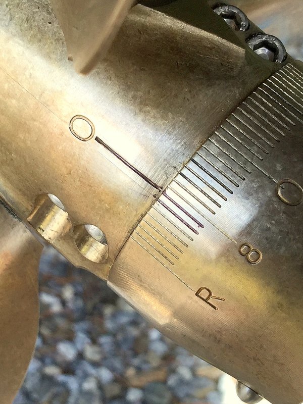

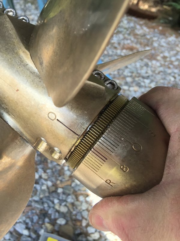

One of the engineering details I loved was the ability to adjust rotation & pitch in about 10 seconds flat or a dive without even a wet suit necessary. Seeing as our boat is considerably heavier than her design weight and drives a 160A alternator plus a Sea Frost refrigeration system it makes it difficult to hit pitch spot on thus I wanted easy adjust-ability. To change pitch on the Campbell Sailor required a short haul and in the end a single pitch adjustment cost damn neat as much as the prop did. here I have two potential pitches marked with a paint pen. #9 Pitch, well not really the actual pitch just a reference # to the pitch you've already worked out, and RH rotation.
To adjust the pitch grab the tail and pull back.
#10 Pitch RH rotation in under 5 seconds....
