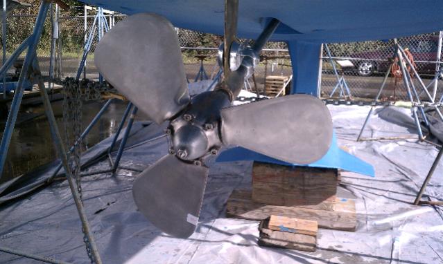

I installed on my H410 in the spring Flex –O-fold 18x14, 3 blades and I am very happy with it.
Very good performance 8.5 +kn at 3550 rpm (50hp Yanmar), min prop walk no maintenance etc.

A good friend of mine had a H460 with an 18 x 17 fixed three blade and put a max prop on it. He loved the performance of that max prop but didn't like the $1500 price to rebuild it after some corrosion issues. He eventually sold that and put a 20 x 15 flex o fold on it and thought it was even better than his max prop...for a lot less money.
