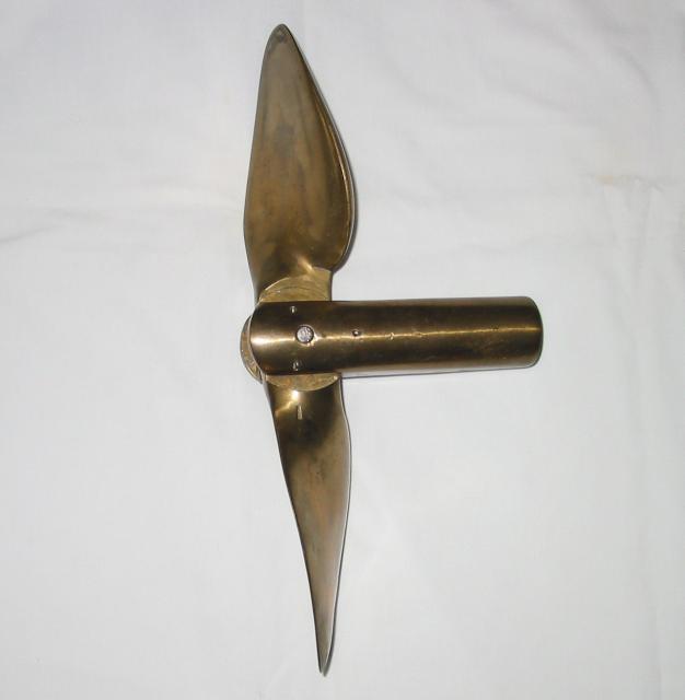

Martec Folding Prop
I am in need of Folding Prop feedback. I will soon be hauling for paint and shaft bearing replacement. I currently have the OEM fixed 3 blade prop which performs well when required but certainly costs me boat speed. I would appreciate some real life feedback from folding prop owners, especially concerning using in reverse! Tight situations and windy conditions demand good engine/prop responce and at these prices I won't be "just trying them out to see which is better for me".
I have a Martec Eliptec RH14Dx10P folding which I used on my Yanmar 3 cyl. Worked great. If this will fit your needs, just let me know.
