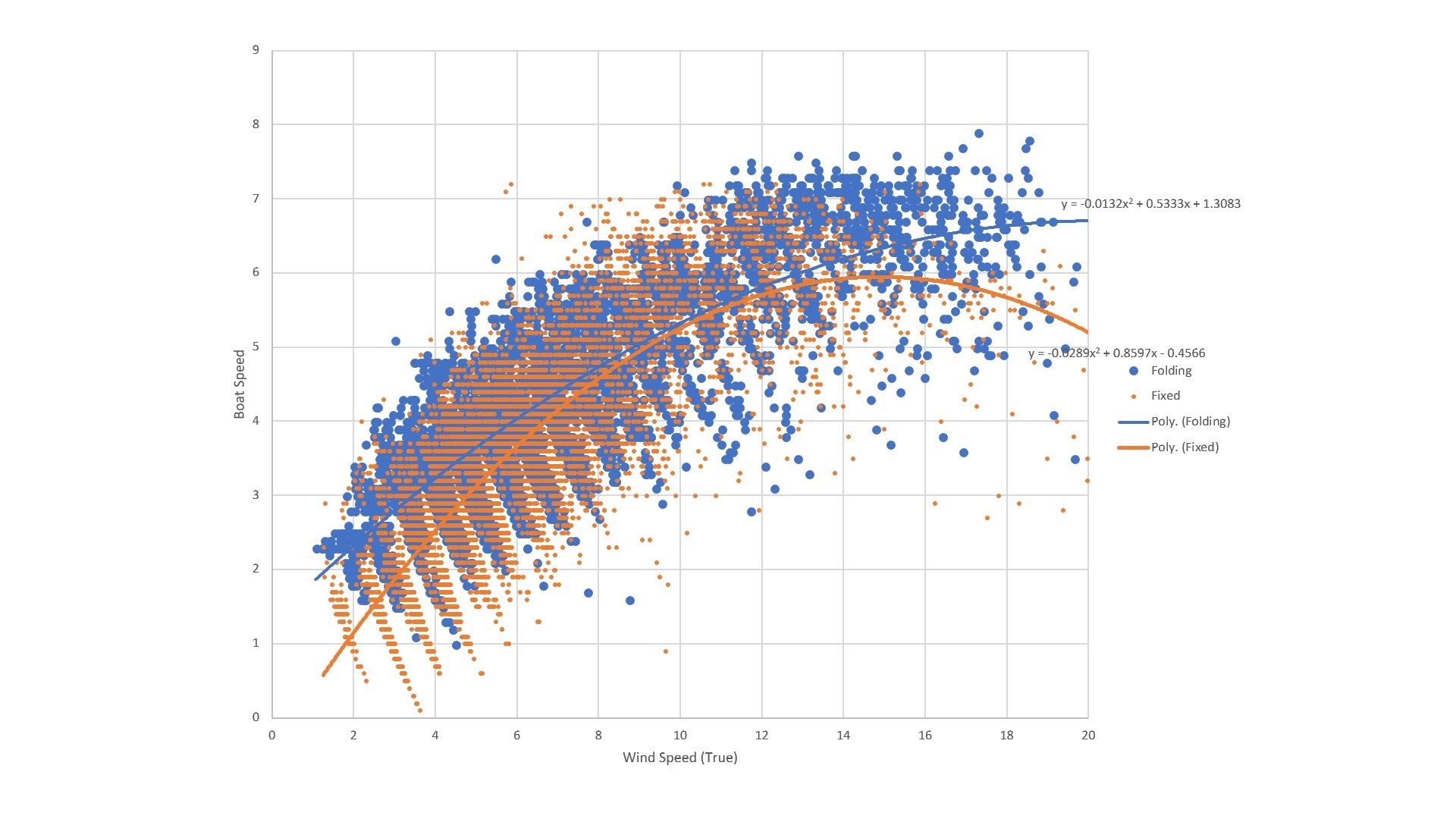

By the way, here’s the plot of my upwind boat speed during a couple years worth of races with the fixed and folding props. Orange dots are fixed prop, blue dots are 3 blade FOF. Lines are the best fit polynomials.
At low wind speeds the difference is as much as a knot. The difference closes when approaching hull speed. As wind increases more the FOF pulls ahead again, because the fixed prop was causing turbulence that stalled our rudder.
Only caveat is that since I had a couple years experience with the boat before switching to the FOF, some of the speed improvement might be from increased skill vice the prop.
