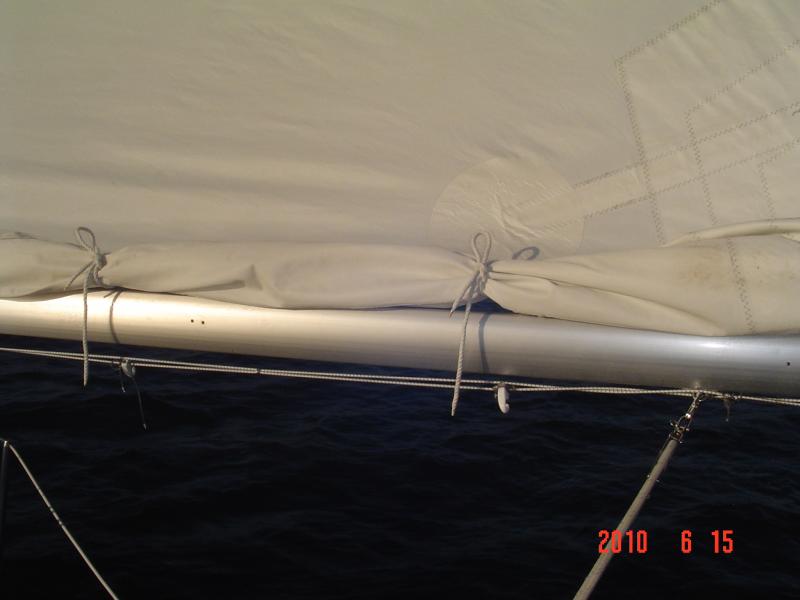

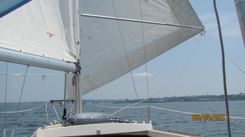

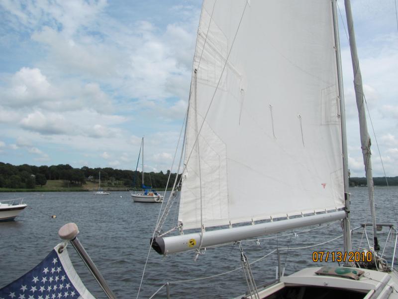

If this sail is good condition and worth altering, I would take it to a sail shop and have them install sail slides to the luff of the sail. I would even go one step further and have the foot of the sail made up with sail slides also. This way, you can tie off the loose sail over the boom instead of under it after you have reefed the mainsail.
The foot of the sail will also set a lot better when you pull on the sail's clew outhaul not to mention that it's going to be a lot easier and faster to put the mainsail on the boom and take it off when you have to.
The best sail track lubricant that I've found is to add a couple of drops of dish washing detergent on each sail slide. That sail will not only go up fast, but it will come down even faster when you let go of the main halyard.
After a nice rain, the soap in the mast track will clean out that track so that it's spotless and you can use your own discretion about whether to add more soap to the slides. Here's a few pics so that you can get an idea of what I'm talking about.
