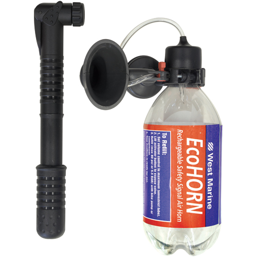

I found a hand pump model that you can recharge. Comes with a small bicycle hand pump. Lasts for about 15-3 second bursts on one charge.

I also sail with an Eco horn. You can alway recharge it with the hand pump. It is quite loud.

I just had a revelation! If the air runs out of the bottle, use the pump to blow more air in between signals.
