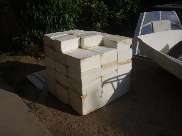

No way I'm gong to argue the science here, if the numbers prove otherwise.
My results were based purely upon removing the blocks and stacking them. The resulting stack, after all the pieces were put together, was 3 feet x 3 feet by 3 feet high.
