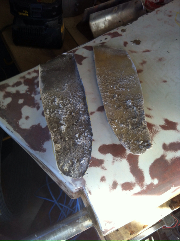

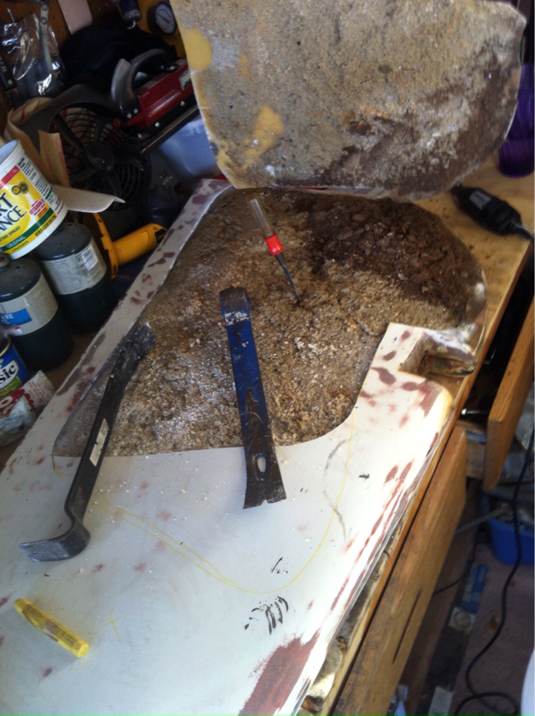

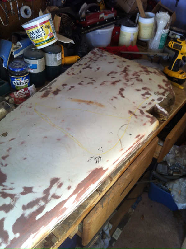

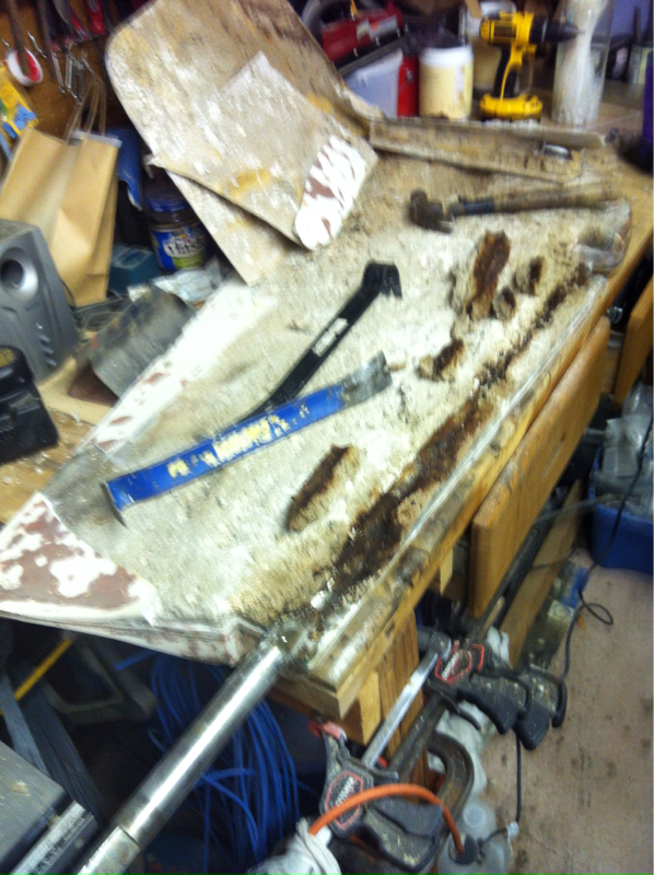

Hi guys I'm rebuilding my rudder. Do I have to remove the old foam? It is still hard. Or can I fair and glass over it? Anyone know where to buy cheap urethane foam? It's hard to tell from the pictures but the fiberglass separated from the foam. My first cut was the seed pic, it shows white stuff witch I think is salt. The de lamination was so bad I wanted to check the super structure, ss shaft and ribs. I found some rust and a little pitting.

What does the center pic show?
Why did you open it up?
If the foam is dry no need to replace it. While it is open drill down to the lowest web to see if any sign of crevice corrosion from past, should be fine if dry.

Rudders have a lifetime. This one has reached the end. Years of saturation, too much corrosion.

Be careful here with the replacement of 'core', as most foam filled rudders are designed for neutral or sometimes even negative buoyancy. If the repair is far different from that original buoyancy you can affect trim of the boat (end to end) and which may affect how the boat behaves in waves (hobby horsing, etc.).
As to what looks like 'salt', thoroughly remove it as it has the potential to 'uptake' water from gaseous 'water vapor' permeating through the fiberglass.
Id suggest a 'test trial' of 'gluing' the existing foam to whatever youre using (probably epoxy) to assure a good 'bond' to that OEM foam ... to validate that the 'aged' core to FRG structure can be done.
Just a small 'coupon' of old core, epoxy it with fiberglass, and then attempt to break that bond. If the 'test' allows it to easily 'rip off', then consider to 're core' the whole damn thing.

Upon further review of your photos, I'd be inclined to buy a new one. Mine delaminated but it didn't look as rotten as yours does. The foam was still rock hard.
