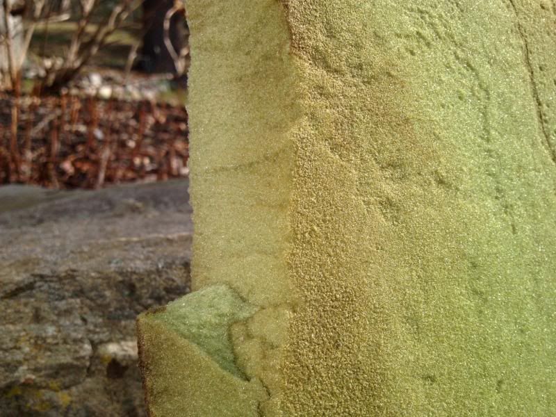

I recently acquired a 1976 Montgomery 17. Part of the starboard cockpit seat was a sandwich made up of the deck layup, a 1" thick slab of green foam core and what looks like 6 oz. fiberglass cloth covering the foam. A photo of the core is attached. I cut out the foam and the fiberglass cloth because the sandwich was delaminating, and now I am looking for advice about replacement core material.
I am thinking about using Core-Cell A500 but I'm not sure what thickness. It doesn't seem like anyone would use 1" thick Core-Cell on a 17' boat. Would 1/2" be enough? Are there any other core materials I should be considering?

Nonsly, first, I think you'll get better answers posting your Montgomery 17 questions here: http://forum.trailersailor.com/forum.php?id=8 It's the Montgomery Trailersailers forum. Lots of experience and advise hanging out there.
Second, I think that looks like buoyancy foam, not structural foam. Any glass over that was probably just for protection of the foam.

To follow up, this foam has got to be structural. It is the only core under the cockpit floor, cockpit seats, quarter births and v-berth, all places that need some kind of reinforcement on a Montgomery 17. Plus, afaik, Montgomery 17s never were marketed as having positive flotation and there is nowhere near 7.5 cubic feet of the stuff in any event. The plan now is to replace the delaminated section using 1/2" Divinycell (more readily available than Core-Cell), epoxy and 10 oz. fiberglass cloth.
