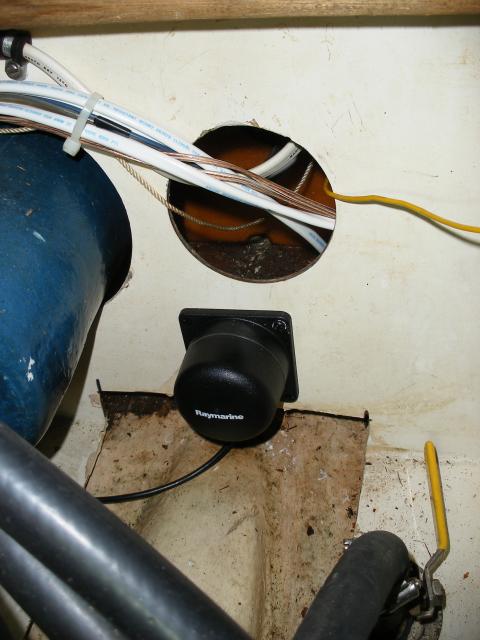

10,060
Yup..Mine is in the same space as Dan's except it is on the fore/aft stringer immediately to the right of dan's in the picture. Since the 34 has a cast iron keel, I was trying to get it as far away from big iron chunks as was practical. If your keel is not iron, the engine and any errant magnetic devices (bilge pump wires, tools, aerosol cans, etc) are all to be worried about.
