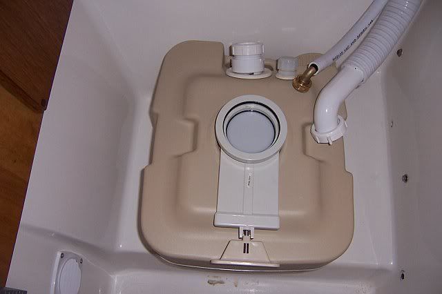

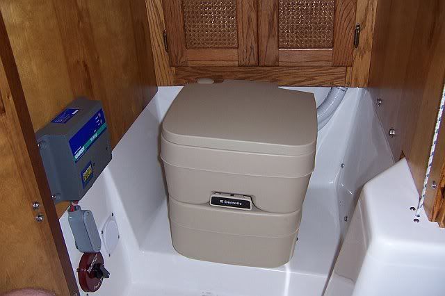

Here's my installation.
No hose clamps yet in this picture, but you can see how easy it is to disconnect the hoses for manual dump, or removal for cleaning.

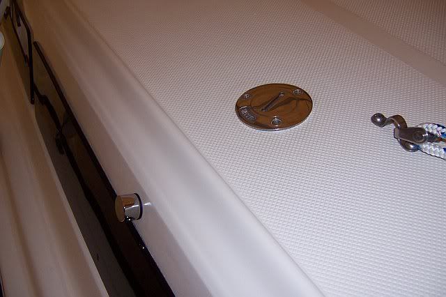

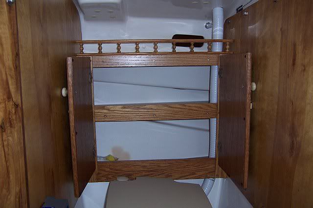

It's easy to run the hoses straight up for pump-out deck fitting and vent. The cabinet I made holds and hides the hoses nicely.
