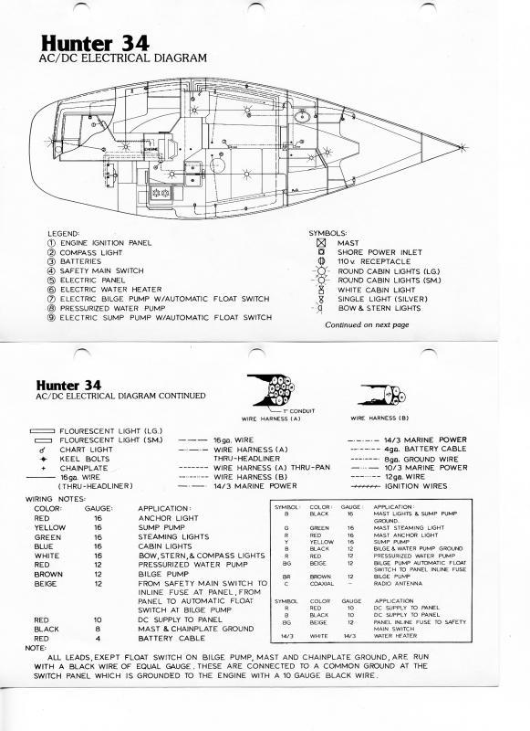

H-34 Electrical
Ed.. for your reference, here is a scan of my original owners manual electrical diagram for the Hunter 34.. Yours is similar.. You can see how they've run the power to the lights on the same circuit..

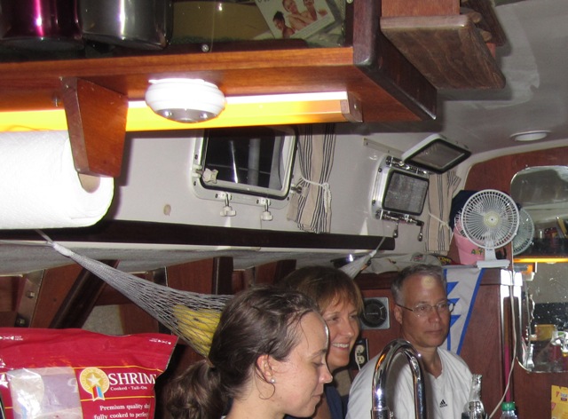

I also have three florescent fixtures in my 1980 36'. Attached is a pic which happens to show the one above the galley. An identical one is over the chart table. I'm not sure if the one above the head vanity sink is the same. My guess is that Hunter did install these. But looking at your picture, yours does appear a different model than mine.

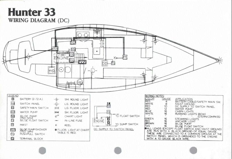

After noticing Kloudie's post with the 34' scan, I thought to look at my pdf copy of the Cherubini Hunter manual that I have which I recalled covers all the models. Here is the 33's DC wiring page which does show three florescent fixtures as included in the original fittings. I don't know if this particular manual version might pertain to earlier or later 33 models than yours. Anyway, seems to show the one above the galley sink plus two others.
Ed H
Sep 15, 2010
244
Hunter 33_77-83 Regent Point Marina, Virginia
Thanks. That is interesting...It shows one in the head. I never noticed one in there. I am going to have to look to see what is there now. Ed H
