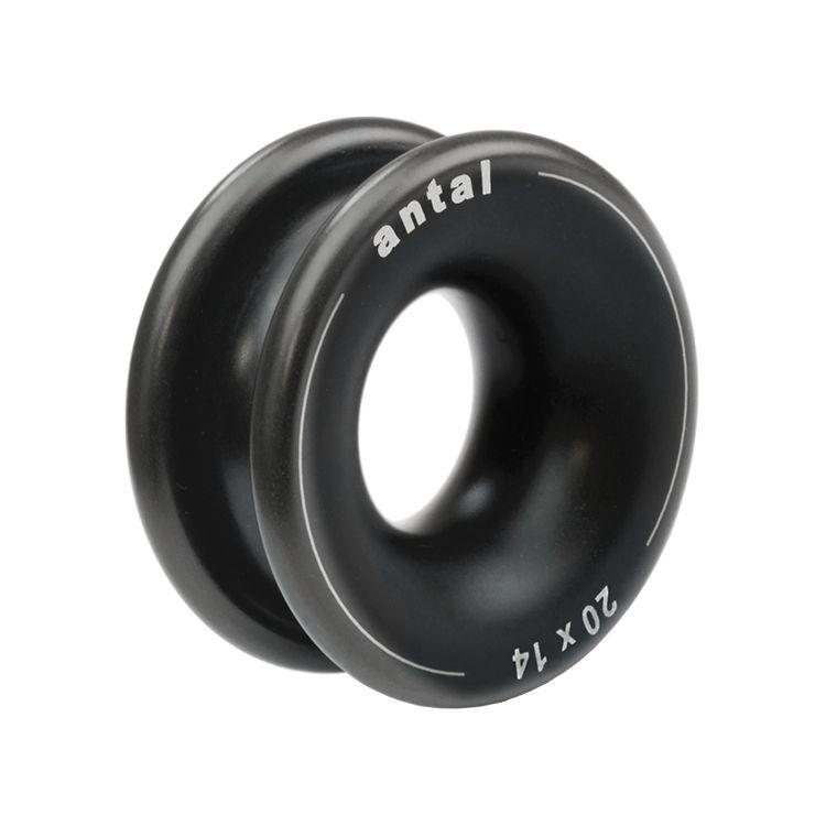

DJ, you could experience a fouled sail. Most tweakers I have seen that have been used on racing dinghies are nothing more than a ring, like the "Antal" ring.
The jib sheet is feed through the center and the control line is tied around the outside.
As you can imagine the tweaks can get wrapped around the jib sheet and restrict the sheet playing out in a sudden change of sail tack.

Here the system on a pogo 12.50. Excuse my weather beaten foot. The Antal low-friction ring is positioned by the two 3:1 dyneema lines pulling in and out. The bungee helps keeps the ring from crashing thru the cabin ports. Again.
Sailing, you end up learning and marking the lines for two uses, adding more twist upwind as breeze builds, and footing farther and farther off the wind when close-reaching.
