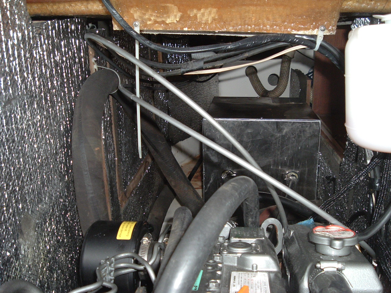

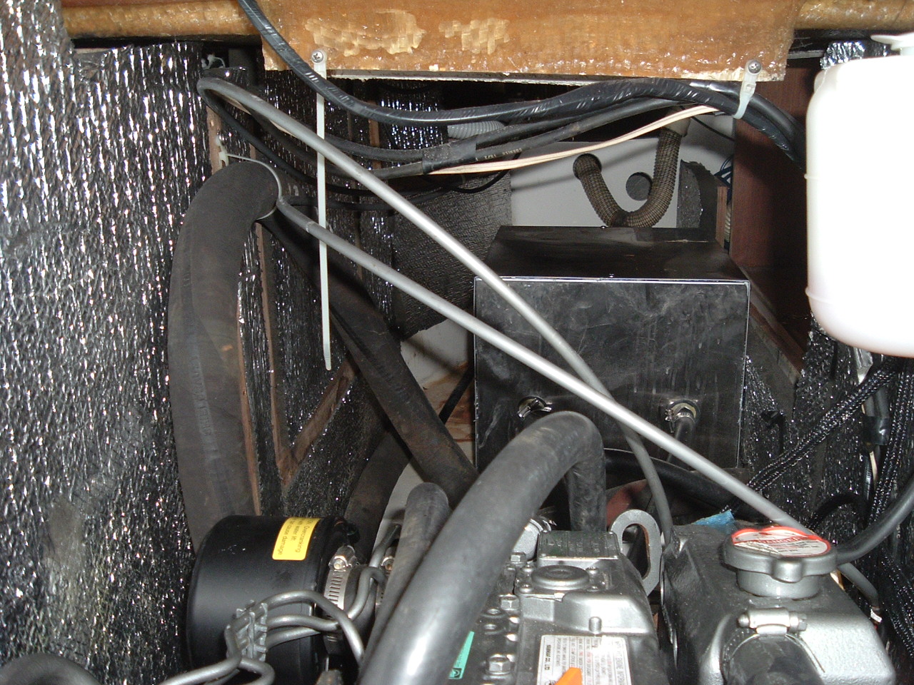

Curious as to why Nanni wants it higher. I want my exhaust outlet lower, in the water where I can hear it gurgle. My new Yanmar had no such requirement. But you do need either a waterlift muffler or some other way to keep water from backing up into the cylinders. In my case I kept the original big loop in the engine compartment.
Ed,
Thank you for your thoughts. That is a great looking, very clean installation. Nicely done!

My exhaust outlet is even lower than that ................ about 3" below the waterline.
What keeps the water from entering the engine is the large loop in the exhaust lie just before it exits the hull. It rises about three feet above the waterline.
