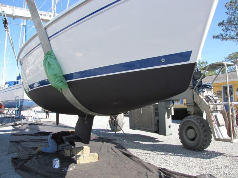

Hi,
I'm contemplating replacing my fix three blade prop with flexofold 3 blade prop. Has any 309 owners any experience this or similar 3 blade folding prop.

Hi all,
My Flexofold prop is now installed. Here are some quick observations:
1. No prop walk! Zero, Zilch, Nada.
2. My 15x9 is little under-pitched, but does provide excellent maneuverability around the marina.
3. I get ~ 6 kts. @ 2800 rpm. Can someone post something on the standard prop for comparison?
4. If I did more motoring I'd probably replace the 15x9 blades with 15x10 blades. Blade sets can be ordered separately.
5. The quality and robustness of the Flexofold prop are outstanding.
6. Performance under sail is noticeably better, but I don't have data as to how much.
Ron

Flexofold Update
Hi all,
I've replaced the 15x9 blade set with a 15x10 blade set. What a difference! I now have the performance I expected. In flat water, I get 6 knots @ ~2500 rpm and 7.1 @ ~3600. Still no prop walk. I love the difference in sailing performance, especially in light air.
If you decide to get a Flexofold prop, order it from the US distributor, Hansen Marine, hansenmarine.com . You'll get better "after the sale" support from Jon Mills at Hansen Marine Engineering than you will get from [FONT=&quot]Keld Willberg at Flexofold[/FONT].
Ron Stubbs
