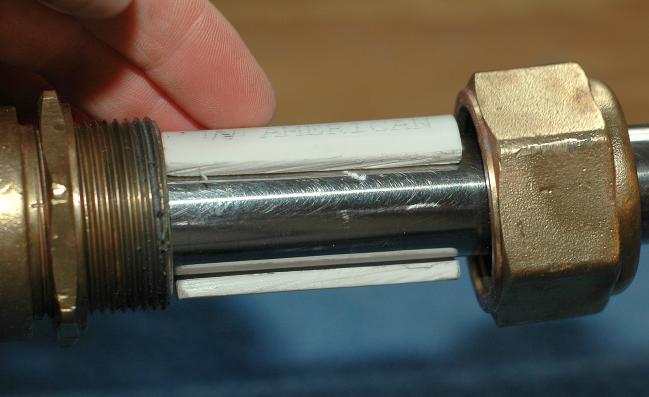

Hi All, I had a bunch of folks ask what I use to insert the flax. I totally overlooked my custom made tool and have added three pictures of it and a description of how to make this tool to my "Re-Packing A Traditional Stuffing Box" article. The link takes you directly to the enlarged first picture of the tool. To read the article and see more pictures click once in the picture and it should shrink it back to normal size so you can see the rest of the article. Here's the link : http://www.pbase.com/mainecruising/image/77332565
