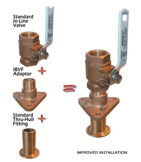

while ordering some flange adaptors the other day i went to several sites .......looking for 3/4 inch ... much to my schgrin every site i went to said they were out of stock or were discontinued......anyone know whats up with that ......

no the flange adaptors that you mount the ball valves to ...the are triangle at the base and have 3 mounting holes to fasten to the hull...they are pipe threaded on the ball valve side and stright threaded on the hull side to accept the mushroom through hull fitting the ones like Main Sail usesin his demonstration of seacocks.....
this is about one of the coolest things i have ever seen in relation to sucking water out of the ocean or draining your sink.....you can change the valves with out haveing to haul out your boat.....

I still think the Groco BV series is one of the best on the market with a bullet proof handle and stem and it can be serviced

Hamilton Marine should have them. Item # GRO-IBVF-750
3/4" (LINK)
All Sizes (LINK)

Do you see any strength issue, comparing that base-plus-valve scheme with the one-piece bronze casting that incorporates a ball valve? (I am not questioning the worth of the design, just looking for some informed opinion...)
Thanks,
LB
Have measured it against many other seacocks including Spartan and some old WC tapered cones and it is a very robust option. Nominal wall thickness on a 3/4" flange is just shy of 5mm thick at the base and at the NPT threads it is just shy of 3mm thick. The nominal wall thickness of an Apollo bronze 3/4" thru hull is 1.5mm or about as thick as a US penny.
So the 3/4" flanged adapter is about twice the thickness of a 3/4" thu-hull which builders like Hunter still slap valves onto, and we rarely hear of a failure. Ericson did the same thing only in Marelon. At double the thickness of a thru-hull wall I doubt you'd ever see one fail.
EDIT: For grins I just measured a very old and "robust" 1 1/2", not 3/4", tapered cone seacock I have in the barn. The nominal wall thickness was about 3mm.
They far exceed the ABYC strength requirement as do most bronze seacocks but the benefit of easily replacing the valve with a brand new one without affecting the integrity of the thru-hull and flange is a huge benefit....
If I was going to have permanently installed bronze seacocks they'd be Spartan's. Of course those run $300.00 +/- each and require yearly maintenance. Much easier to spin a new valve on every ten + years or so...
