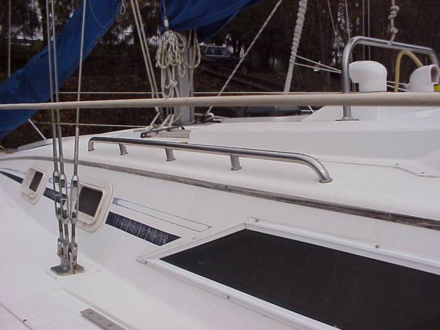

Tom: You can get a syringe and inject it into the area. You may have found a void, but the entire area is not empty. The decks are cored and normally you will find something solid in there. When they construct these areas they use pieces of coring material and they have spaces between them. If you drill the hole thru the top portion only and fill with the epoxy then you can drill the hole thru to the interior. We have our exterior hand rail attached in this method and it looks fine (of course that is my opinion). On the interior we have medium fender washers and acorn nuts. It looks like the boat came from the factory that way.

Brett: Our boat is a 1985 Hunter 31'. The rails are not back to back but offset.

If so, do the bolts show on you deck? If they are not thru bolted do you feel comfortable with their strength? Or, did Hunter place a steel plate in the deck that these rails screw into? That would have been very nice, but I would assume they would have done the same for the outside rails. We have a 1984 and the rails are back to back. Sorry, Steve I am probably asking too many questions.

Brett: Hell they have been there for 15 + years. I would not expect any problems unless the core gets wet. I am sure that they are just screws. What boat do you have?
