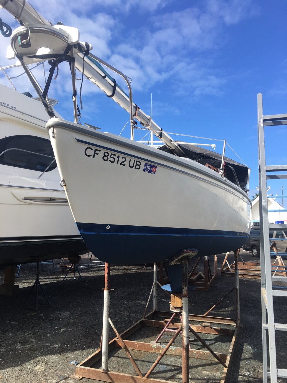

The bottom paint is almost finished. They lifted and moved it to paint the stand spots today. Back in the water next week!
