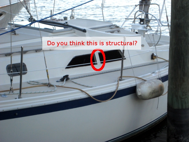

One thought that struck me is that if I remove the middle fiberglass, I could make it one big window where the back could slide part way forward. I'm wondering if that fiberglass is structural/load bearing. See photos and let me know what you think.

I've never seen a split saloon window on an O'Day 34. Are you sure that is not an aftermarket addition by a PO? Having said that, it doesn't look like a bad idea as that means only half of the window has to be replace when needed.
Since its in there, I'd leave it. Perhaps you can install an opening port in the aft area and go for waterproof instead of weatherproof.

The picture above is without the acrylic in place. While I had it out to work on it, I took a lot of measurements and started wondering about better options.

Scott, That piece is on all 34's and 35's, it just gets covered up by the acrylic. From the inside it looks like two windows, and from the outside, it looks like one large window. Along with me and my family, the photo shows the window and if you look carefully, you can see the center support behind the plex.

Another thought on removal of the support posts. Look closely at your posts in the picture you sent and how they line up dirctly with the mainsheet traveller on the coach roof. I doubt this is a coincidence. The posts are there to prevent flexing of the coachroof as the mainsheet loads are close to vertical in the traveller.
I too never liked the screws holding in the plastic but I always figured that was secondary retention with the bonding material/sealant acting as the primary retention. The screws are probably just to hold it in place with the curved shape until the adhesive/sealant cures. It would be tough otherwise to clamp it in position.

jibes138 I think you're right about the posts lining up with the traveller. I'm going to abandon that idea, but I'm still going to look into getting 2 fixed windows made that have a real frame inside and out. I think that would still look good, and be a lot more durable than the plex.
