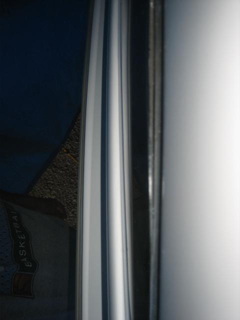

Over this past year, the large fixed starboard lexan window on our 2004 H260 warped slightly and broke the bedding seal for a distance of approximately 10". The gap is approximately 1/16". An included image is looking straight down on the broken seal with the boat aligned north/south. This window is probably 3-4 feet in length, and the rest of the seal and bedding looks to be in good shape. I have researched the forums and found instances where the window is removed in its entirety and rebedded, but I was hoping to reseal the gap area only to make it through the year. Has anyone tried such an approach with any success? I'm not sure if you can do this sort of thing by re-applying DOW 795 over the top of itself. Thanks for your help!
