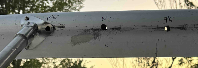

Greetings Sailors. My name is Dan. I live in Albuquerque and am new to sailing. My 1983 MacGregor 21 has a bent mast. I have a new mast. In swapping out the hardware from one to the other, I seek advice and have a few questions. Are there any upgrades to components or design that I can incorporate into this refit? If this project has been detailed in video and available online, please share the link. If this project is detailed in writing please direct me to it. Overall, what components or fittings should be replaced, what components or fittings can be upgraded to a newer design and what components or fittings can be reinstalled?

The spreaders seem to have been set at three different heights (see photo). Why might this be? The three holes for the through bolts as measured from the foot are 9’6”, 10’1” and the spreader is currently at 10’6”. At what height should the spreaders be installed on the new mast? The drawing from 1977 indicates 10’6”.
Regarding the fitting that connects the spreader’s root to the mast: should these fittings be reused, or replaced or is there a newer design? Should the spreaders be replaced, or reused? Please see photos. And a related question: this fitting is fastened to the mast in three places; with a through-bolt, a screw, and a third bolt and nut. This third bolt is a bit of a mystery: the bolt heads seem to be on the interior of the mast. Please advise.

One focus of concern is the indicated location of the spreaders at 10'6".
My bent mast, possibly the original, was drilled at two locations below this level, and I am wondering why.
Any ideas?
