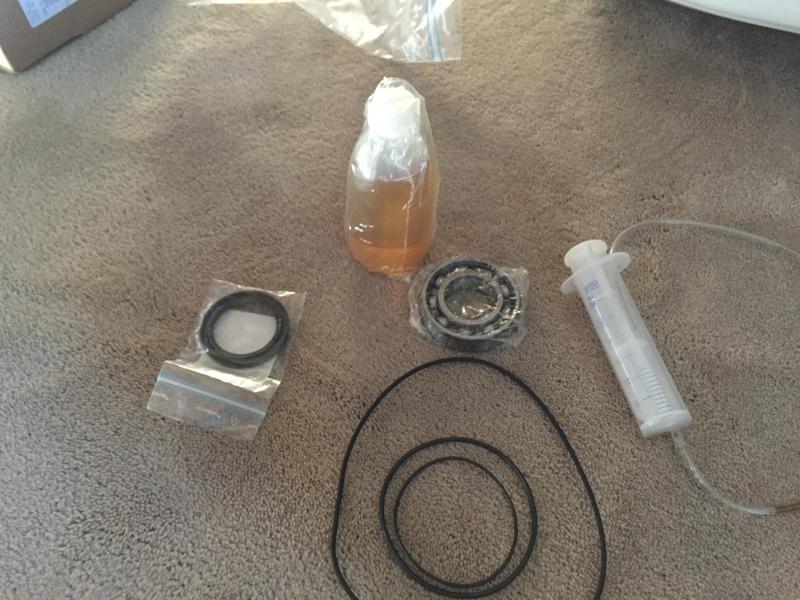

There was a thread back around Xmas that spoke to the undocumented fisher panda bearing needing to be replaced at 1000 hours. I spoke with FP and it is true. On my 2004 genset with 700 hours on it, I was noticing clear oil in the bottom of the locker around the genset. It was not diesel nor was it old engine oil. I just kept wiping it up and wrote it off as engine oil that was spilled when changing the oil. I was wrong. It was 80-90 gear oil, that was leaking out of a shaft seal in the back of the motor. On my 41 you need a mirror to check the site glass on the forward end of the gen set. At launch this year there was NO oil visible.
Changing the bearing is a bout a 3-4 hour job for an experienced mechanic. The kit costs about 150 from FP and includes a bearing, seal, new o-rings and oil. I really only needed a seal, as the bearing was fine, but to get to the seal everything needs to come apart so you might as well change the bearing too.
If you have a FP genset, make sure that there is oil visible in the sight glass on the end of the generator. In the December thread someone had said that their failed bearing destroyed the generator side and was quoted over 7000 for just those part.

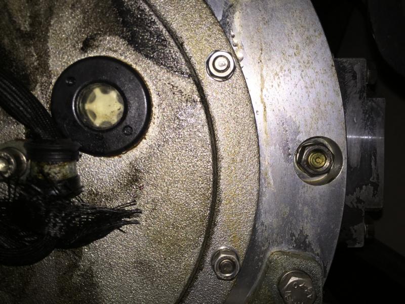

it is located in a bearing and seal retainer that is located under the end plate with the site glass in it. If you look at the pdf that I included, you can see the parts explosion.
