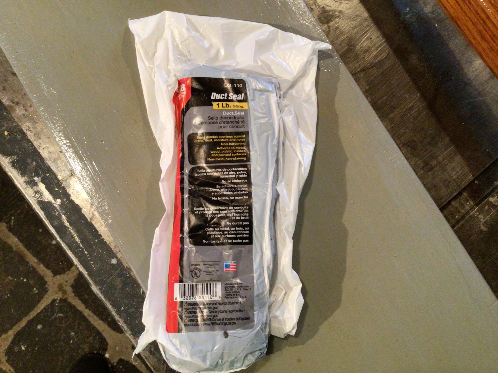

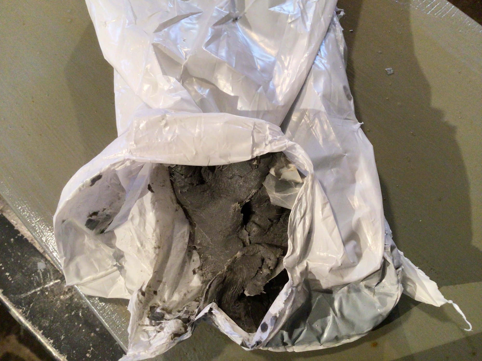

A quick little solution to losing those pesky small screws (and for some reason, can’t quite put my finger on it) they get smaller every year.
Get some Duct Seal. It’s in the electrical section of Home Depot. It’s the stickiest of stuff, but cleans off perfectly.
Just tear off a piece from it, smear it into the slot of a screw or on the end of the screwdriver and when the screw is backed out it will stay stuck to the tip of the screwdriver.
I have a friend who was constantly losing the screws for the mast plate down the mast each year. Gave him a 2 inch square of this stuff and he never lost a single screw again. That was 9 years ago.
It stays soft in any weather condition, regardless of temperature, leaves no residue, reusable, stays put wherever you put it, vertically, horizontally, upside down…it don’t matter.
It is truly a miracle product that works.
It comes in 1 pound sticks. Thats enough for the entire marina or an individuals 40 year supply.
If you ask for it in the store they may not know it by its name, older electricians call it “monkey sh$t”.
Try it, you’ll love it.

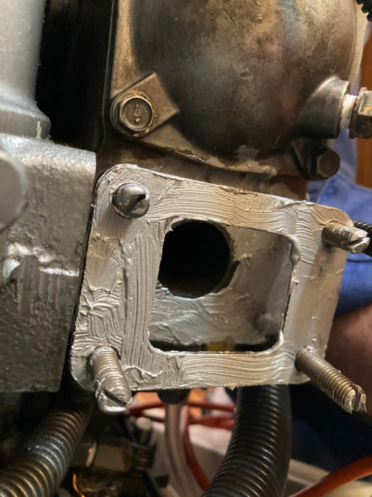

I'll be brief here (if that's at all possible).
Insert two opposed M4 studs in the holes. Make sure they protrude an inch or so. You are then ready to apply the gasket and then cover plate using the studs as guides. Insert a couple of original screws to hold everything together. You are then ready to insert all of the original screws (minus 2). Remove the two studs and replace with the original screws.
It's the only way to replace my mixing elbows short of jack-hammering out the surrounding bulkhead.
Ok,,
This is almost exactly what I was going to write up, but a bit more refined (tiny bit)
Here are the issues:
Why on earth FP used tiny slotted screws in a place that would be super prone to dropping in the bilge just makes shake my head .
Especially, on the sub-floor gensets. You have a horrible time with firstly locating and starting the screw while holding the gasket and the plate.
And, how do you endure the gasket isn’t crunched up under the cover ??
Here is the low-cost, never loose stuff in the bilge again solutions
Parts list
6 M4 x 12 SS Allen screws with hex drive
6. M4 SS nuts
6. M4 SS split lock washers
Blue locktite
Dab a tiny bit of loctite onto the set screws, and insert till bottomed out
Wait till set
Then you now have exposed studs to hang the gasket and front cover on to. Pop on lock washers & nuts. Use a tiny open ended ratchet to finish tightening after getting hand tight.
You could literally do this blind folded in your sleep. Zero stress.
About $2 in parts for a perfect solution to an annoying problem
