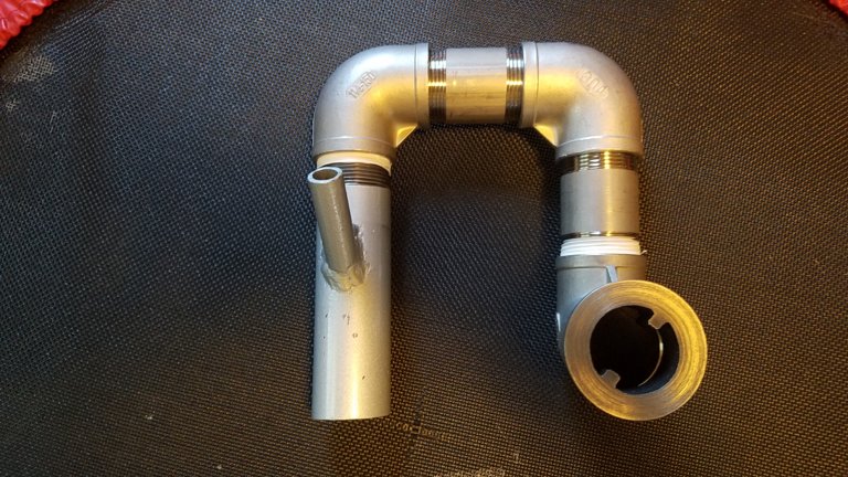

Exhaust riser: The riser was 20 years old so figured it was time. Read where folks used plumbing parts to replace it so thought I try it rather than the $600-$700 for one from Catalina Direct. This turned out to be much easier than I thought it would be - went with stainless using the design mentioned on this forum (image attached). Easy to remove the old - I have the V-clamp style - and easy to make the new one and install. BTW, the old one turned out to be in pretty good shape!
