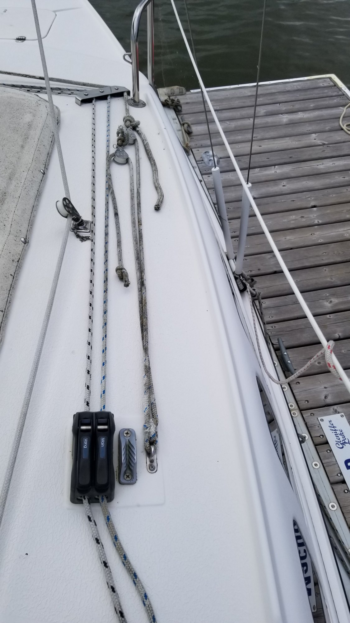

It does have the 2:1 blocks in place - I'll measure it this evening but I want to say I could only get the line to "travel" about 6 inches. I had read on here that it shouldn't be all that difficult. Looking at the assembly diagram fo the keel in the manual it doesnt' look like the line should have to move that far as it attaches to the upper portion very close to the pivot point. I'll snap a photo tonight and measure the travel distance. I doubt the line has ever been replaced as I've read has to be done sometimes.

A picture of the lines with the board up and then down. What I am looking for is the first block tied to the uphaul line resting against the deck organizer in the down position after hearing the down klunking noise
