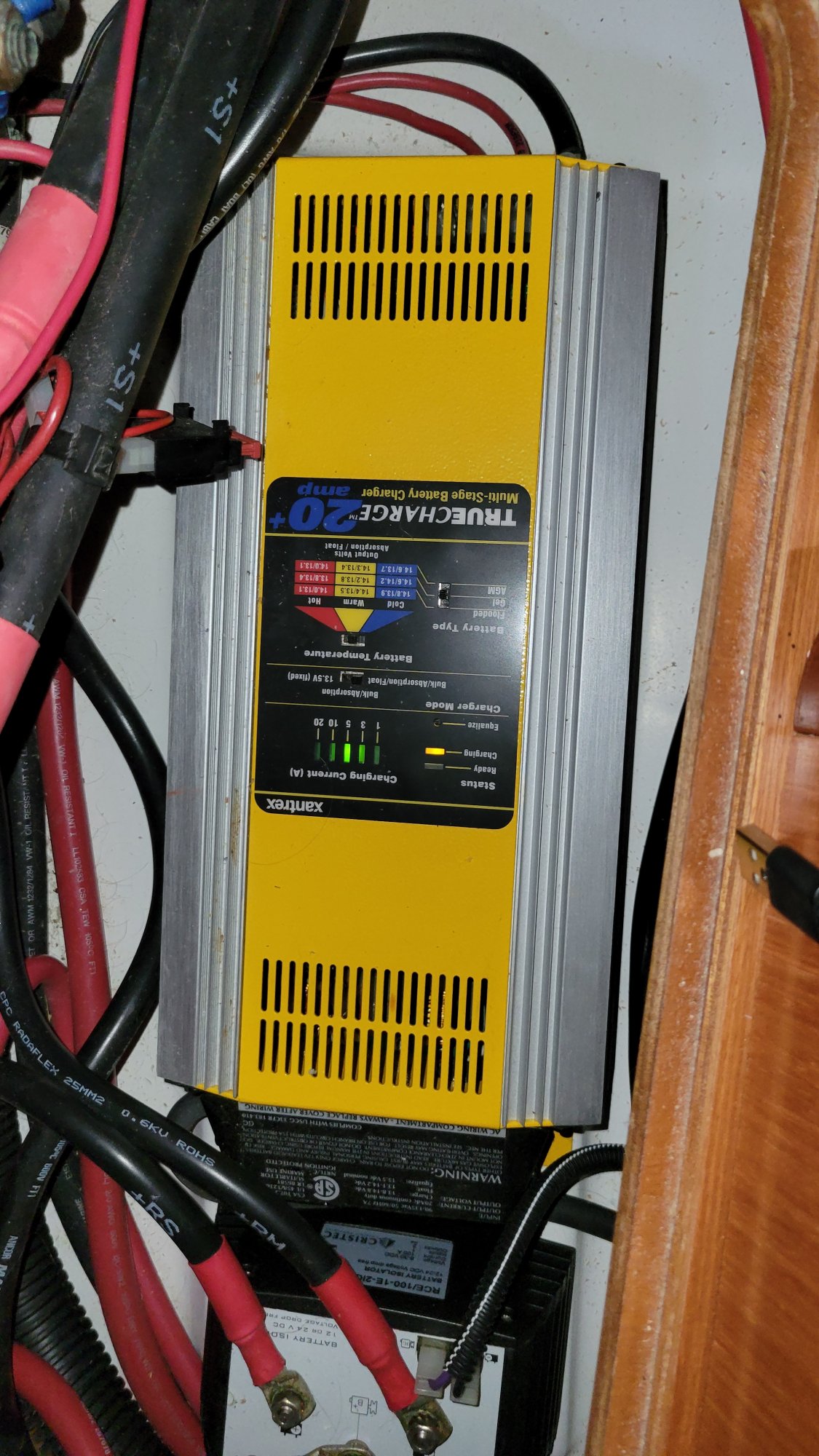

As an update, we were on the boat the rest of Saturday, through Sunday morning. The alarm didn't sound again. I kept checking the voltage the house batteries were usually around 13.2v and the starter batter around 13.8v, although both fluctuated. The highest I saw on the starter batter was 14.3v. I guess I'll replace the house batteries and see if that solves it. I guess I should also switch the charger from Gel to AGM. Does anyone know what the implications are of charging AGM batteries with the switch on the charger set to Gel?
23,798
Simultaneous Three-Battery Bank Charging
Truecharge+ has three separate DC positive terminals to allow charging of three separate batteries (or battery banks). The total current into the batteries is a maximum of either 20 amperes or 40 amperes, depending on the model, which is divided amongst the batteries according to their state of discharge.
Note: The three outputs are not independently voltage regulated so it is important to avoid systems with mixed types of batteries
I have not played with the Xantrex charger. The above is from the manual. Which you can find here. http://www.xantrex.com/documents/Discontinued-Products/TC20_40(445-0050-01-01_Rev-A).pdf
If you have AGM batteries you will want to use an AGM profile. Make sure you identify the battery. Make sure you identify the way your battery system is wired. It sounds like this is a new boat to you. Congrats. Previous Owners have been known to modify (improve) their boats after buying them. Identify what you have and how it is wired before altering things.
For sure the selector on the charger should be set to meet the requirements of the batteries you have on board.

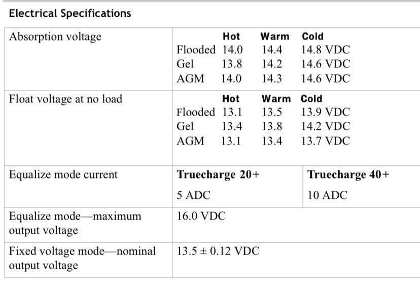

Here are the output voltages for your charger -
The Gel float voltage is a little high for AGM’s, which wouldn’t be great for their longevity. The table also matches your measured voltage of 13.8 for the start battery and ~13.2 for the house - since the house is often under load it may float a little below the target 13.8.
The alarm may have been triggered if the charger went from float to absorption mode. I know the Truecharge 2 does that every week for at least a few minutes; maybe the original Truecharge has a similar process. The absorption voltages, at least at “warm” should all be under the alarm threshold of 14.75, but maybe there was some kind of temporary fluctuation. Or maybe it targets the absorption voltages in the chart for the lower (house) bank, driving the engine bank up higher.

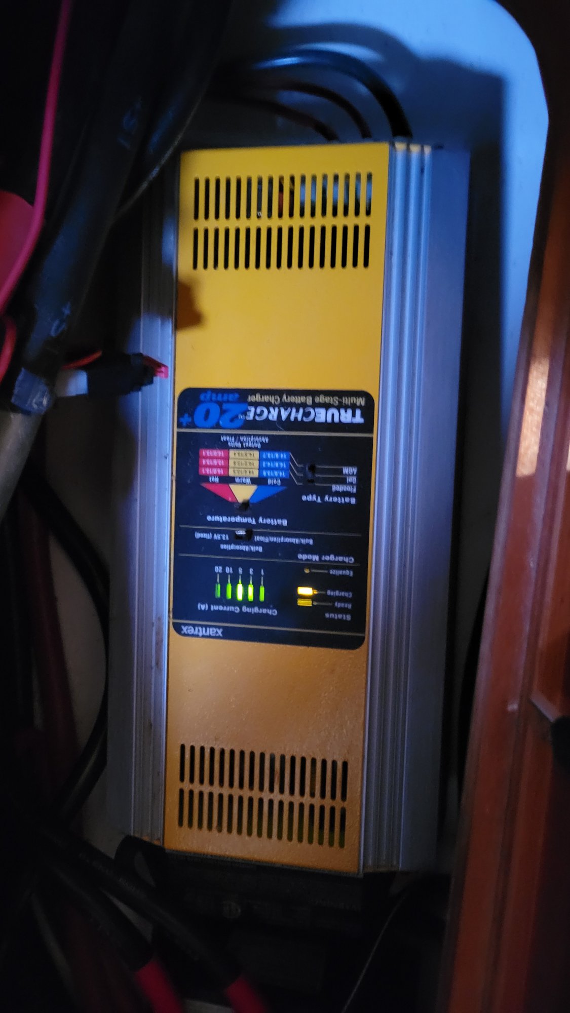

Thanks everyone... I switched to AGM and confirmed that all 3 are AGM. As I said earlier, the house batteries are older and need to be replaced. It sounds like the voltage of that battery may be dropping and causing the newer starter battery to spike. When I was on the boat today, the house batteries were at 12.8v, which seems incorrect.
Until I get new batteries, should I turn off the starter battery to prevent it from overcharging? I don't want to turn off the house batteries since they are needed for the fridge, bilge pump, etc.
May 17, 2004
5,898
Are you going by battery voltages reported on the DC panel or measuring with a volt meter directly on the batteries? We have some voltage drop between the batteries and the panel, so even though the panel often reads 12.8-13.3 (depending on loads) the house batteries are actually at 13.2-13.4. If the bank is actually at the higher level then I wouldn’t use that as a signal of battery health.
Also, if yours is wired like mine the charger connects to the battery side of the switches, so even if you turn the switches off the batteries still get charged. Now that you’ve switched the charger to AGM I wouldn’t worry about overcharging the start bank. The charger should float at an OK voltage for it.
