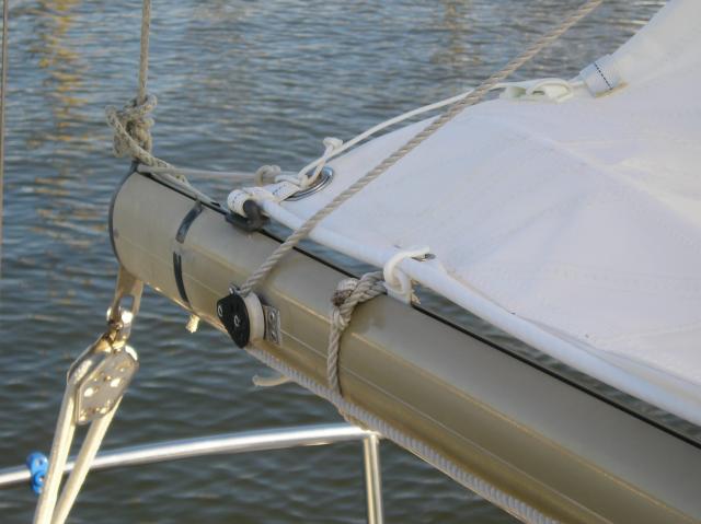

Purchased a DS3 end of last year. It was an 87 and actually came with the original owners manual. I am really a picture kind of guy, and can't figure out the rigging part of the sail to the boom and mast. The manual had pictures, but technology isn' what it is today. There is a couple of blocks and cleats on the boom, but I can't figure out what goes to them. Are there any other sources to get the rigging right ? Some good pictures would be great.

the blocks and cleats on the side of the boom are almost certainly for a slab (jiffy) reefing system. One reefing line at the aft end of the main, one at the fore end. Usually, the line is attached to one side of the boom, then reeved throught the sail's reefing cringle (the metal reinforced hole), then affixed to the other side of the boom. You ease the halyard so the main can come down, pull on the fore and aft reefing lines so the sail comes down in a slab, cleat off the reefing lines, then retighten the halyard. The newer standard systems are set up so you only have to yank on one reefing line.
I bet my Oday 23's reefing system and boom set up are similar to the DS's. I have a few photos of my Oday 23's boom set up (the aft reefing line anyway) that might be of help. Unfortunately, the website is not allowing me to insert images for some reason. If I can figure it out, I will post them later. Sorry about that.

Here are those pictures
