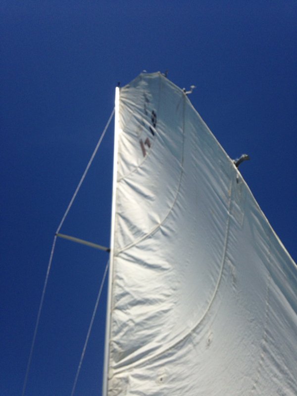

First, I assume you are sailing on Kerr Lake or Buggs Island per Virginia sailors?
It would be more handy if we had two side views with one concentrating on the attachment area of the boom to the mast and the second of course at the top of the sail. I cannot tell if the sail is up all the way. In ADDITION, IS THIS THE ORIGINAL SAIL?
The 18.5 for those who are not familiar with this boat is a fixed shallow draft wing keel on a single axle that was replaced by the Hunter 19 water ballast. On the 18.5, the attachment of the boom is permanently affixed to the mast with no downhaul for the boom nor the sail except for the single reef point on the forward of the sail.
It would appear that the sail is up all the way with the sail fully extended backwards by the outhaul; however, additional side photos would verify what I suspect if the age of the sail is included. The 18.5 production was stopped sometime about 1991-1992.
I would tend to think if the sail is original, the sail material has stretched over the years while the bolt rope has shrunk. No amount of pulling or tugging will eliminate that. Then the only two options are to get a new sail or send the old one off to be repaired noting what I think is happening. It is also possible I sold that boat originally.
I hope this helps you sir.
