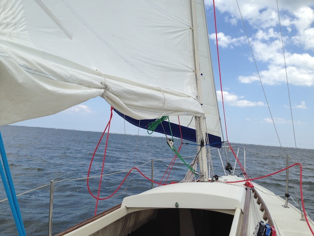

Then I tried that Heaving To thing I kept hearing about. Wow, is that neat. I stopped, had a quiet bite of lunch, then continued sailing.

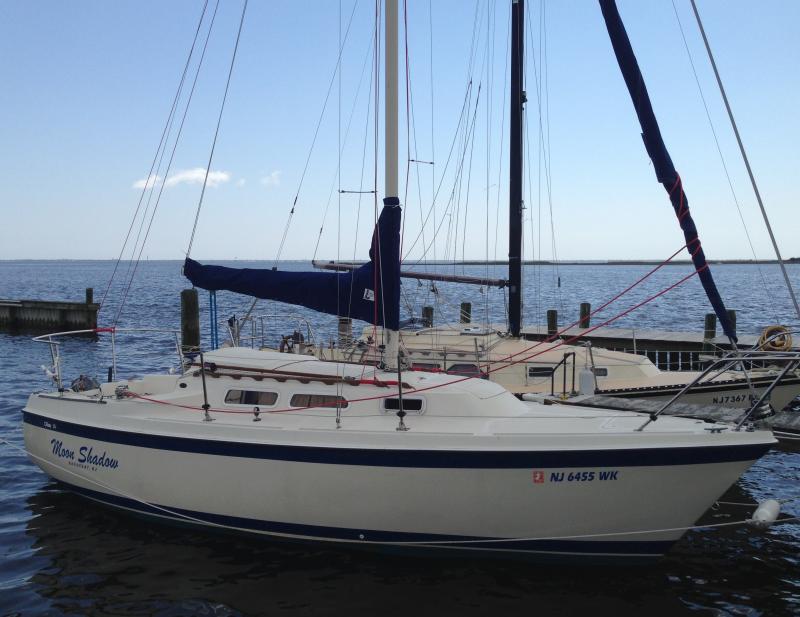

Photo 1 is of Moon Shadow in her slip

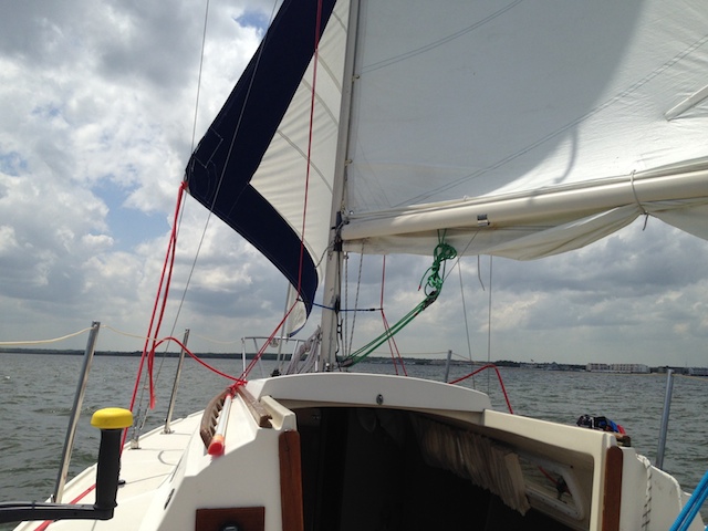

Photo 2 is while on a close reach to LBI.
Photo 3 is while Hove To.

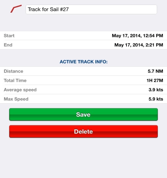

Photo 4 is the track info from the Navionics App I run on my iPad.

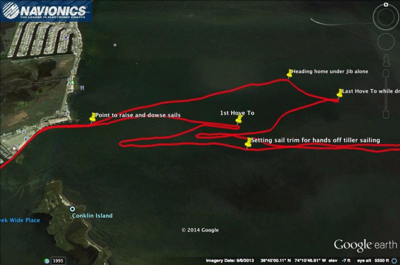

And here is the track as recorded by Navionics and transferred to Goodle Earth.

The lady sure looks mighty fine in the pictures! Shows a lot of TLC.
The pictures and the annotated log track is a nice addition to the trip documentation.

Nice looking boat.
You should look into lowering your jib so the tack is closer to the bow. As it is, it really has screwed up your jib lead angle; they are way too vertical and apply much more pressure on the luff than the foot. Your jib is probably mis-trimmed almostt all of the time.
Ideally, the jib sheet angle would continue through the headsail and bisect the luff 50:50.
Another way to deal with this would be to move your jib lead back, but becase the 25 did not come with jib tracks, you're out of luck here.

Congratulations on your first sail of the year... Your boat does look beautiful. Jackdaw's comment is well taken about the jib sheeting angle. You might consider installing jib/genoa tracks in the future. Enjoy your time on the water this summer! Pat

JackDaw and others. The jib originally had the pendant at the head with the tack attached directly to the furler. Besides draping over the pulpit it blocked visibility. Being new to sailing, I took it off and put it on the bottom but then went to my 135.
We have enough wind I never fully unfurled the 135 last season so I went back to the 100. I now see why it should be at the top and will put it back the way it was.
Jib tracks are on the project list but after a new traveler (the original is useless) and new sails.
