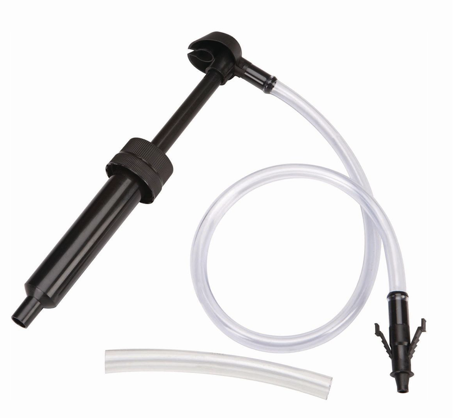

A pump my be a tool that facilitates oil filling when limited vertical access is an issue.
Harbor Freight $9.99

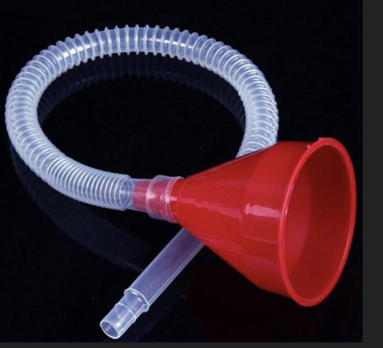

Maybe an oil funnel with a flexible hose.

thank you both! I had a flexible tube funnel but the way I had to get it out to where I could pour it meant that there was a decent dip in the flex tubing and made filling difficult.

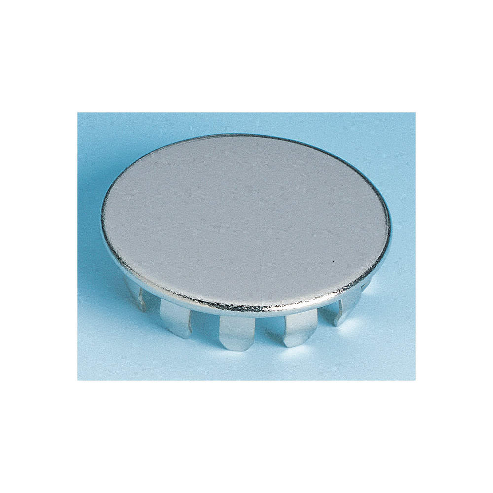

Chances are your engine is under the companionway ladder and has a piece of plywood going from side to side over it. Drill a 1'' hole over your oil fill and using a funnel with a tube inserted through that 1'' hole you'll easily fill the engine. You can easily find a plastic plug to cover the hole in the plywood floor when not in use.
I was about to suggest this exact solution. It is what I did. The most difficult part is locating the exact point to drill the hole.
