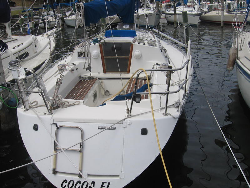

Now average 30 footer can go either way, but for IOR-influenced boats like the 30e, the very narrow transom can cause issues when reaching. When reaching, the pole is all the forward, a straight line from your transom block to your forestay (where the guy meets the pole on a reach) is WAY inside your lifelines. See pic. A tight guy/sheet running outside your lifelines will press so hard against your stanchions they will bend. Dedicated guy blocks (and lines) solve that. Make sense??
