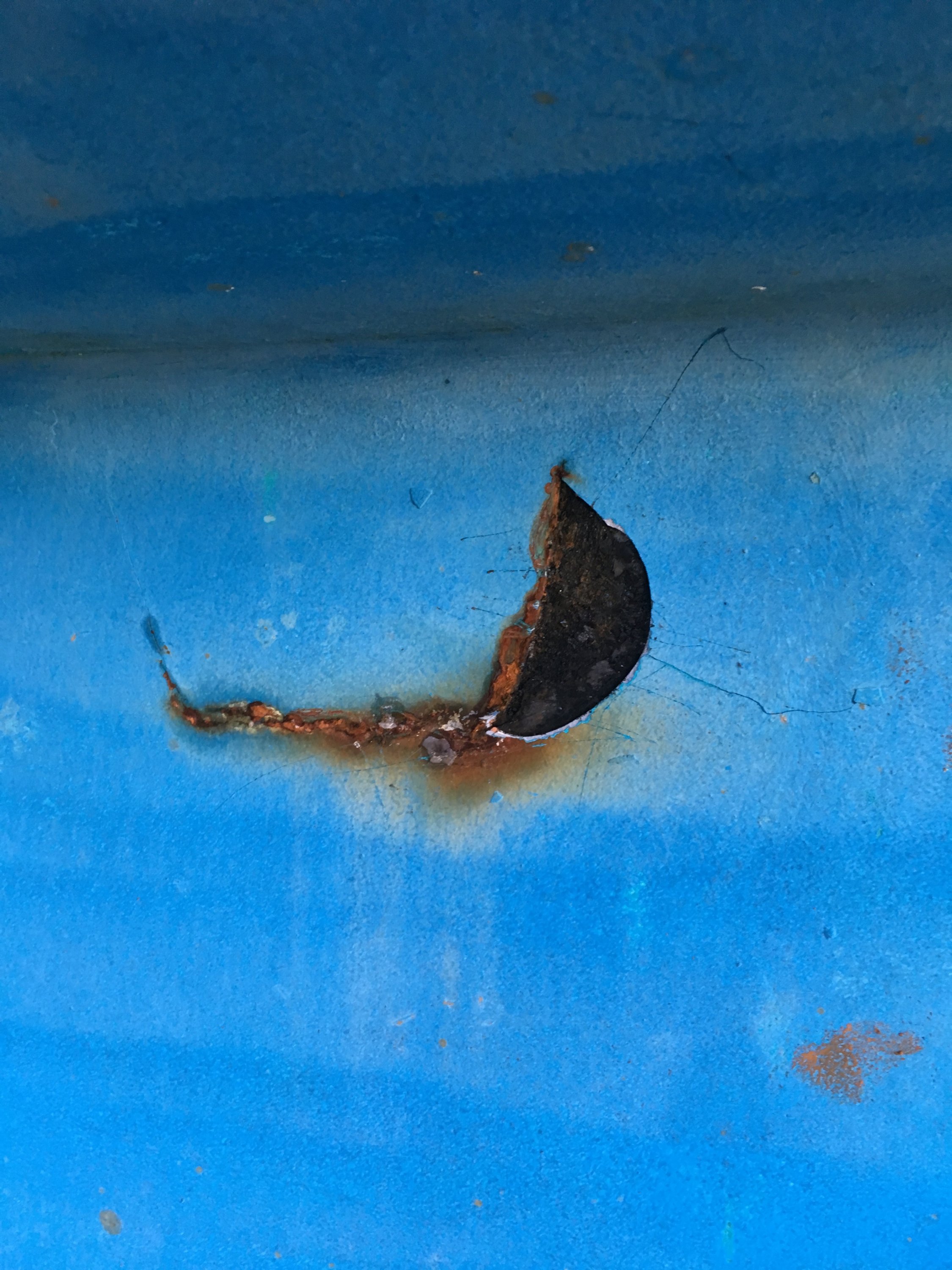

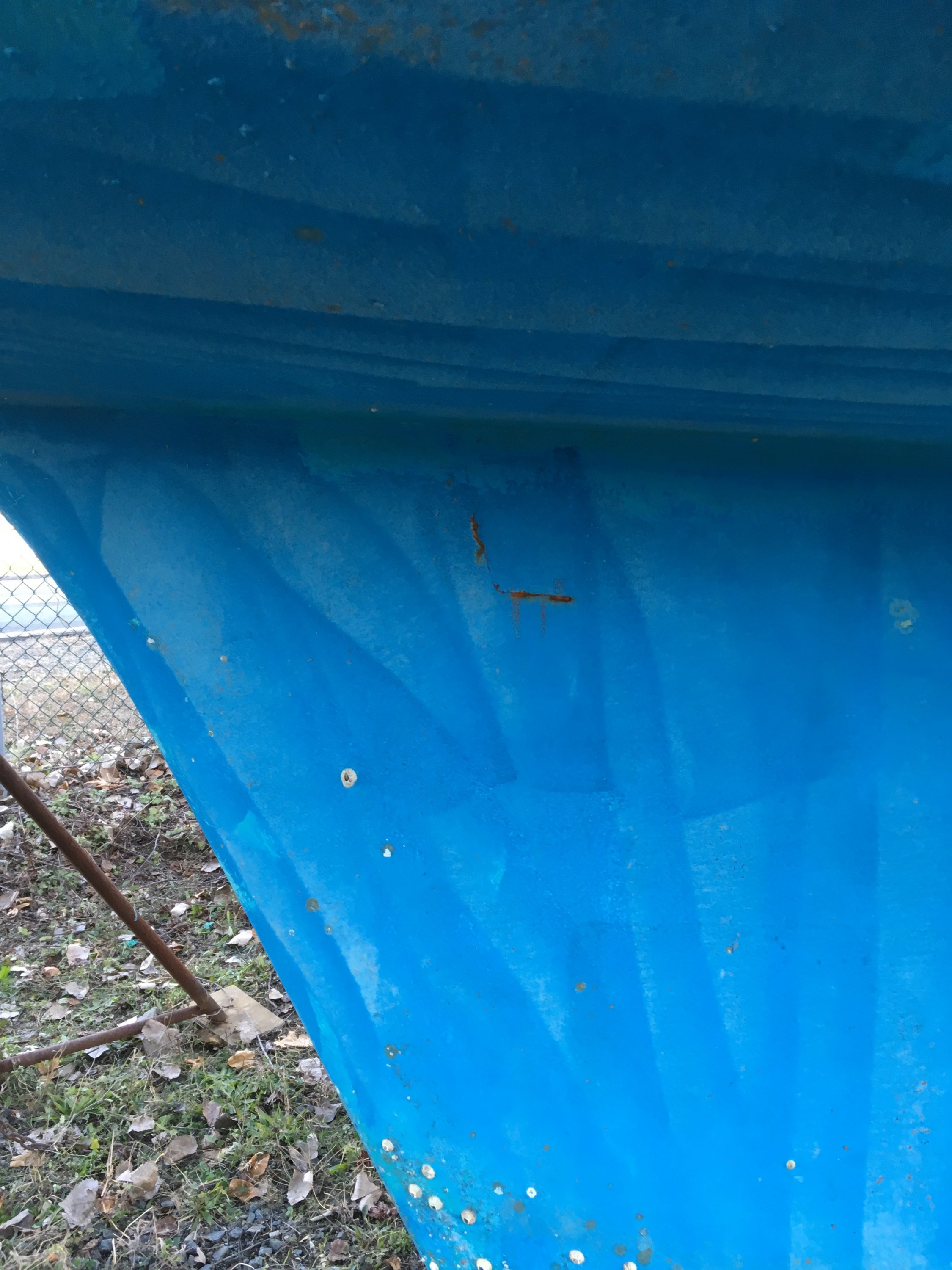

Hello all.
I've a 1985 Beneteau First 29 and there is an odd rust pattern approx 6" x 4" on either side of the encapsulated cast iron keel about where it joins the hull. When shopping I saw the same pattern on several other Beneteaus (285s and 305s maybe?). Anybody know what this is about/if it's a problem/how to remedy?
Thanks!

The First 29 does not have an encapsulated iron keel. It is a cast iron keel, normally sealed in epoxy paint, that has been bolted on externally. Where that pattern is should be solid iron and under no particular load. Kinda weird.

Thanks for the correction. So encapsulated keels (I just learned) are continuous fiberglass construction with the rest of the hull with the ballast in said "capsule" of space. What you describe is certainly more in keeping with what I see: there is a section where the epoxy has cracked away exposing the cast iron.
It is weird. Especially in that I've seen it in multiple boats. What I don't see is any kind of seam where the keel joins the hull. I'm presently debating what I more terrified of: trying to change the keel bolts (imagine original) or potentially dropping the keel whilst underway....

I assume that is the keel joint. Many have steps rather than a single plane on the keel. This would show that 90° pattern. I have witnessed the same pattern in Hunters.
Not much chance of that. While cast iron will surface rust if exposed to water, it is very durable. The bolts might rust, but that is from water that enters that area from inside of the boat.
If you don't see that hull/keel joint that means that it was well faired at the factory and still in great shape.

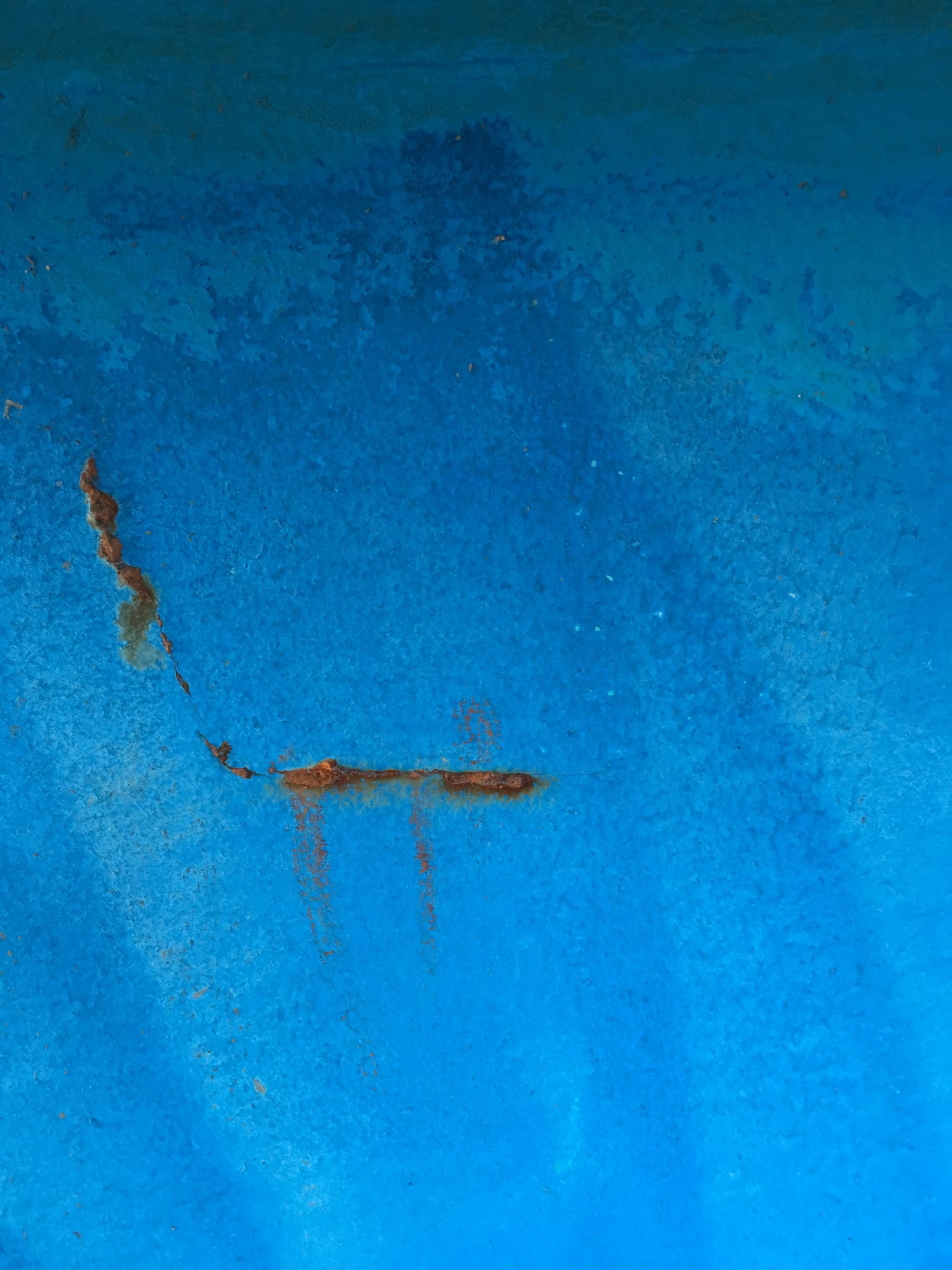

That's the kind of image I was just looking for. Things are starting to make sense. Especially because the other side looks like this:
So there's a breach in the epoxy coating, water bleeds through at the joint and rust registers at the other side tracing the outline of this keel key of sorts.
Which all makes my stomach sink--do I need to drop and rebed this keel? The big project this off season is to put on a copper epoxy bottom so whatever it goes on top of should be sound....
So when folks are talking about changing keelbolts, really from these images, it seems to be the case that we're talking about changing keelbolt nuts, no? Are the threaded rods typically cast in place with the cast iron keel?

Can't speak to First 29, but that pattern looks like a good indicator to me. I did some more searches and found the Bene 235 scantlings: It shows a step albeit wider, so the builder is not a stranger to a more complex keel to hull joint shape.
I like the idea personally, it would seem more surface area for bonding and shearing protection for the bolts. My O'Day has an encapsulated keel, no keel bolts.
For Ducharme: Try to identify how water is reaching the iron; if it is loose keel bolts (torque nuts) allowing an external crack, or migration through the bilge. i.e is the rust on the outside the root of the issue or symptom of a deeper issue type thing. There are many articles in repairing at both extremes from the catalina smile (caused by flexure of the hull at the keel stub) to dropping and rebedding keel. I have successfully repaired a catalina 25 using G-flex. It is still holding after 5years. The epoxy hardens to a flexible matrix, which is what I attribute to success.

Ducharme,
From what I see in the three pictures you posted, it looks like the epoxy coating has been scraped or gouged by something from the outside, possibly from something floating in the water or an underwater obstruction. If so, the simplest fix would be to grind down the coating around the gouge, grind off the rust from the metal, passify the rust with a rust inhibitor made for this purpose, and renew/repair the epoxy coating in this area.
I agree with Jackdaw. Cast iron is very durable and any rust on the exterior will be cosmetic. Rust does expand, however, (compared to the iron), and so if water gets into the space between the coating and the iron it will cause the coating to bulge out.

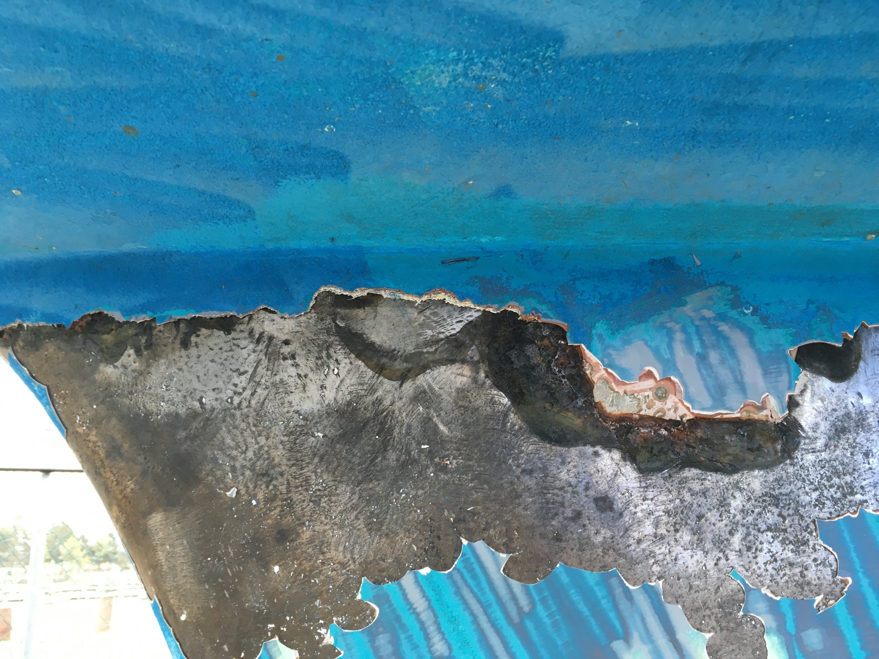

Many thanks to all for all the information and advice.
My update: indeed, that trapezoidal indention at the top of the keel would appear to be the bilge trap for the bilge pump. I believe that some combination of leakage here and at our keelbolts (several have severely deteriorated washers) allowed water through from the bilge and into the seam.
Didn't sand or sandblast but chipped the old epoxy away with a beater woodworking chisel and deadblow mallet. Fairly quick work but did show good adhesion through the bulk of the keel surface. Feel like it's worth the work in advance of the new copper epoxy bottom and did show signs of moisture intrusion that were not previously visible from the exterior (as seen in photo).
Now here's the funny thing I found: fiberglass. There is a section of glass cloth bridging the area between hull and keel, masking over the joint. Funny, right? I'd always read that there was a seam, and said seam was bedded with one's extremely durable compound of choice and then I expected that the next thing would be your bottom paint whatever that would be. But glass cloth???
