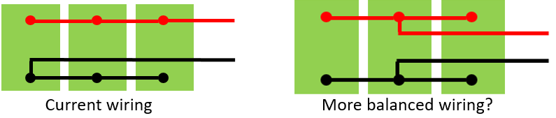

No
NOT MORE BALANCED.
You will charge send a charge across the middle battery.
CURRENT SET UP IS BETTER.

So in the interest of obsessing over this (since I can't be sailing right now), I'm wondering if I would achieve better balance in charging my 3-battery bank by changing from my current parallel schema to an adaptation of Impact Battery's "perfectly balanced charging" diagram (article here: How to Charge Lead Acid Marine and RV Batteries in Parallel | Impact Battery ). Thoughts? Disparaging remarks?
This is what I am using with 3 batteries. The math works as long as all the interconnecting cables are equal length.
