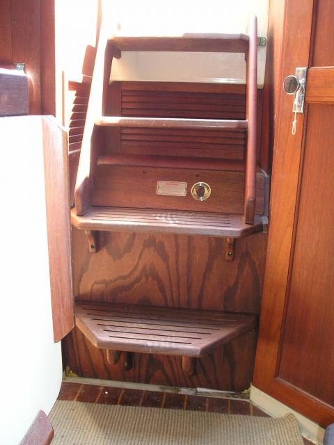

8,050
Beneteau 323 Annapolis MD
My Benny 2006 has a fire port in the stairs/engine cover. The port is really just a plug in a hole. Something like the hole-plug in a desktop that lets wires through is about what it amounts to.
