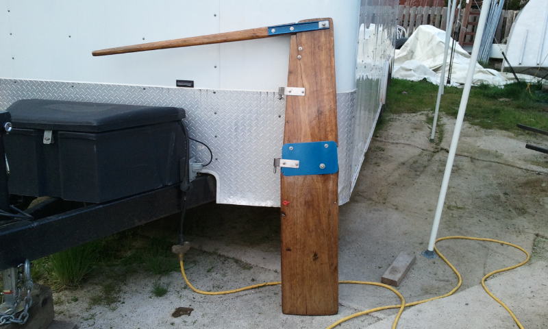

I have the rudder ready for finishing and I know epoxy is the best to use, but as a day sailer, do I need to go to the expense of using epoxy? I think polyester resin would be ok for my usage. even if I do keep the boat in the water for any length of time, I can always ship the rudder....
I dont know why I keep going back and forth on this simple decision, but to hear someone elses thoughts might put my mind at ease.... thank you

thank you for the reply.... and NO, I dont want to have to do it again. I am weighing the fact the epoxy has no UV stabilization, and the rudder on this 21 is easy enough to handle (with a safety rope tied on) to pull the whole thing aboard......
I would like to keep the wood look, even though it will be glassed over, but I dont know what to do about the UV situation... are ther UV stabilizers I can add to the epoxy?
I will admit I am not going to do the glassing myself anyway.... I will hire it done by a local fiberglass shop that does custom work. I think by the time I set up to do it, and buy what supplies I need, I will be close to the cost of having it professionally done. I have done fiberglass work before so I dont need the experience, LOL..... it wasnt so much fun then, and the experience I have tells me there wont be any happy thrills in it this time either.

you make it sound so easy...... I was thinking i needed to encase the wood entirely in cloth...... I would atleast like cloth on the sides to give it strength.... the upper piece has a crack running about 2/3 the way down it that im going to drill clear thru (fore and aft) and run a piece of stainless all-thread thru and bolt it together. and countersink the hardware so its buried and hidden
the PO used it fine the way it is and the crack has no movement, but in my opinion stronger is better. I DONT want to have to do it over... if I only need to thin it and paint it on so it soaks in, then it should be a simple project.

I am pretty sure it is teak.... it looks like the rest of the wood did when took it down to bare wood. I used Epifanes on everything else... its all too shiny now. I need to polish and wax the topsides and deck to blend everything together. the rich, dark wood doesnt seem to fit with the white hull and light blue trim.... from the contrast of seeing it when the wood was all exposed, faded and gray.
the rudder wont stay in the water for any length of time..... maybe a week at a time.
the PO had a small twine he attached to a hole in the rudder blade that he tied up..... it would break easily if he grounded the rudder. I was thinking of rigging a bungie rubber or stainless spring to keep it down, but still allow it to swing up if necessary. I will figure out how im going to do it when I get it all back together...

I took everyones advice and did it all myself with epoxy.... top quality marine grade stuff from TAP Plastics. it takes surprising little to do the job and I bought a quart of resin and a pint of hardner (mixes 2-1) and used a squeegee instead of a brush. I gave it 4 coats and it came out very nice... I used a quarter bottle of resin. after about 6 weeks of curing I will give it a couple of coats of epifanes for UV protection.
the crack you see running verticle in the upper Board was solid, but I thru-bolted it fore and aft in 2 places with stainless all-thread... I countersunk the washers and nuts and then filled the recess with epoxy putty and sanded them smooth before installing the first coat of resin....
