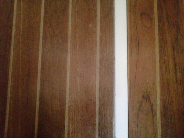

On my teak & holly veneered sole (original 1980 Hunter equipment), I used a satin (low) gloss WATER based polyurethane floor varnish instead of oil based. The result is nice to my eye. The product doesn't give the teak the yellow/orange look that oil based finishes can do. Four years on, my application has resisted scuffs and damage. It is still well adhered to the floor. Water based floor finishes and varnishes are available at all major paint and hardware stores (such as HomeDepot and Lowes).
Attached is a pic of my sole. Not too bad for 31 years.
Nov 14, 2006
93
Hunter 27 Lake Lanier, GA
Looks good. I realize I need to do something, otherwise they will darken and get splotchy, and I am not sure how many more times they can be sanded.
