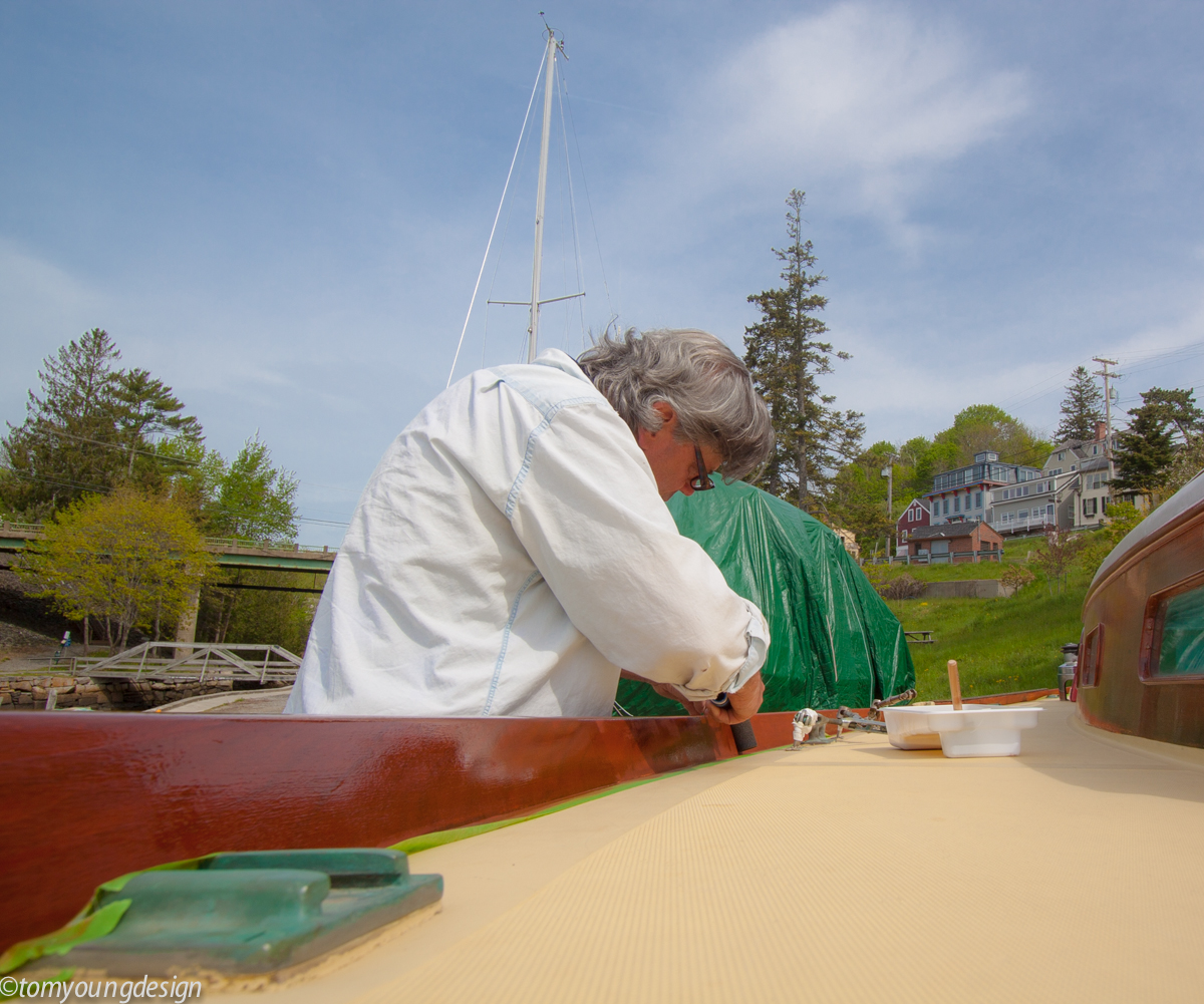

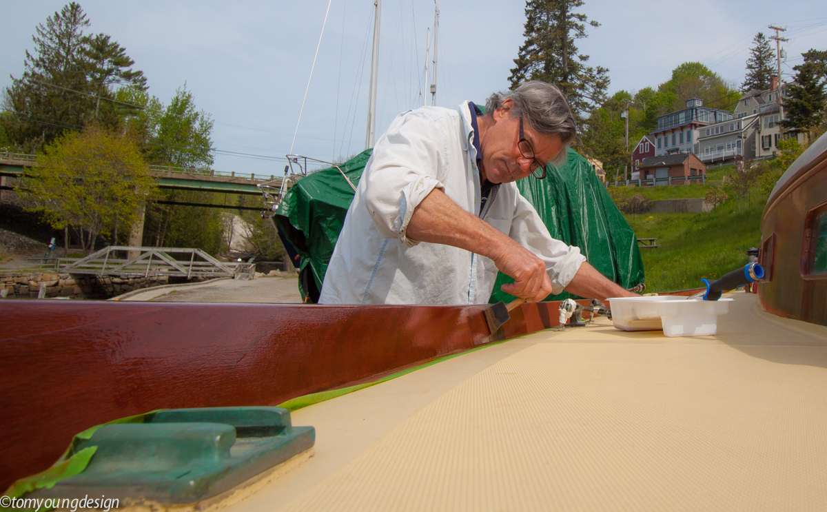

The Schooner Rebecca, designed and built (at Benjamin and Gannon), on Martha's Vineyard in 2001, gets a light sanding for a spring maintenance coat of spar varnish.
The boat has sailed a lot in 17 years with 2 Atlantic crossings, extensive cruising in the Caribbean and Mediterranean. She now sails the coast of Maine and New England.

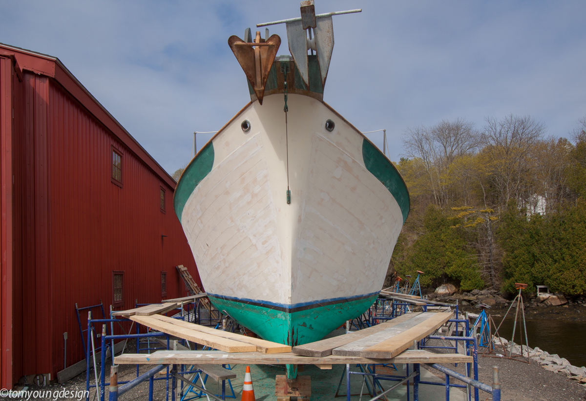

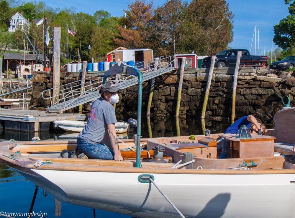

Most of the brush noise is on land. The sheds are full so work is overflowing onto the harbor. I'm a design builder so I find staging enthralling. This mobo has a tall topsides. The pipe staging has been set so the, sander - followed by the roller and tipper - can each reach the edge of the toe rail. You can usually tell the amateurs by their staging (or lack of). This old boat will look brand new in a few days.

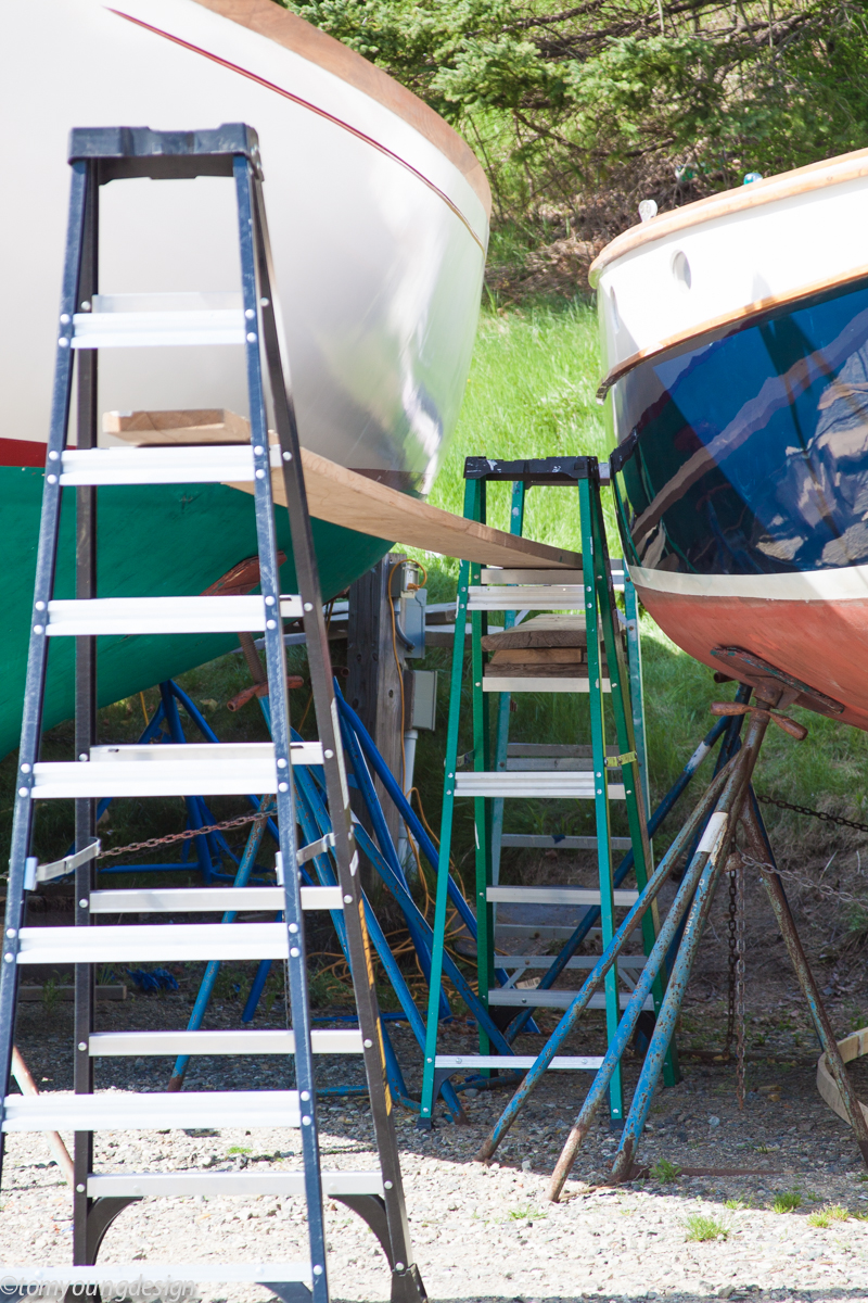

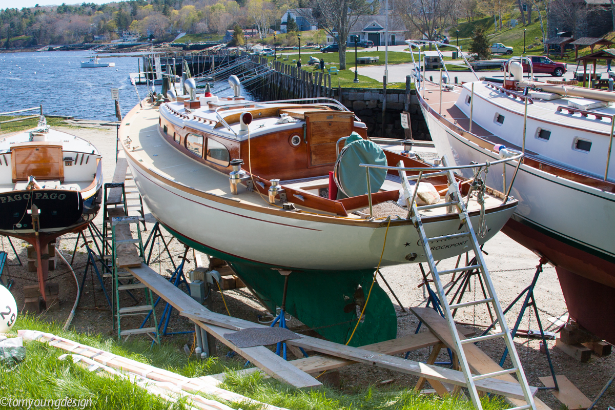

Speaking of staging, I watched a young couple wrestle with a heavy buffer on a hull, at head height. What a work out that would be! Good thing they were young and the boat, small. All they needed was a plank and some cribbing that's lying all around a boat yard.
I stand where I intend to work on the hull, hold my hands at a comfortable height and measure up to the center of that work area. That measurement is how much I need to raise my feet.

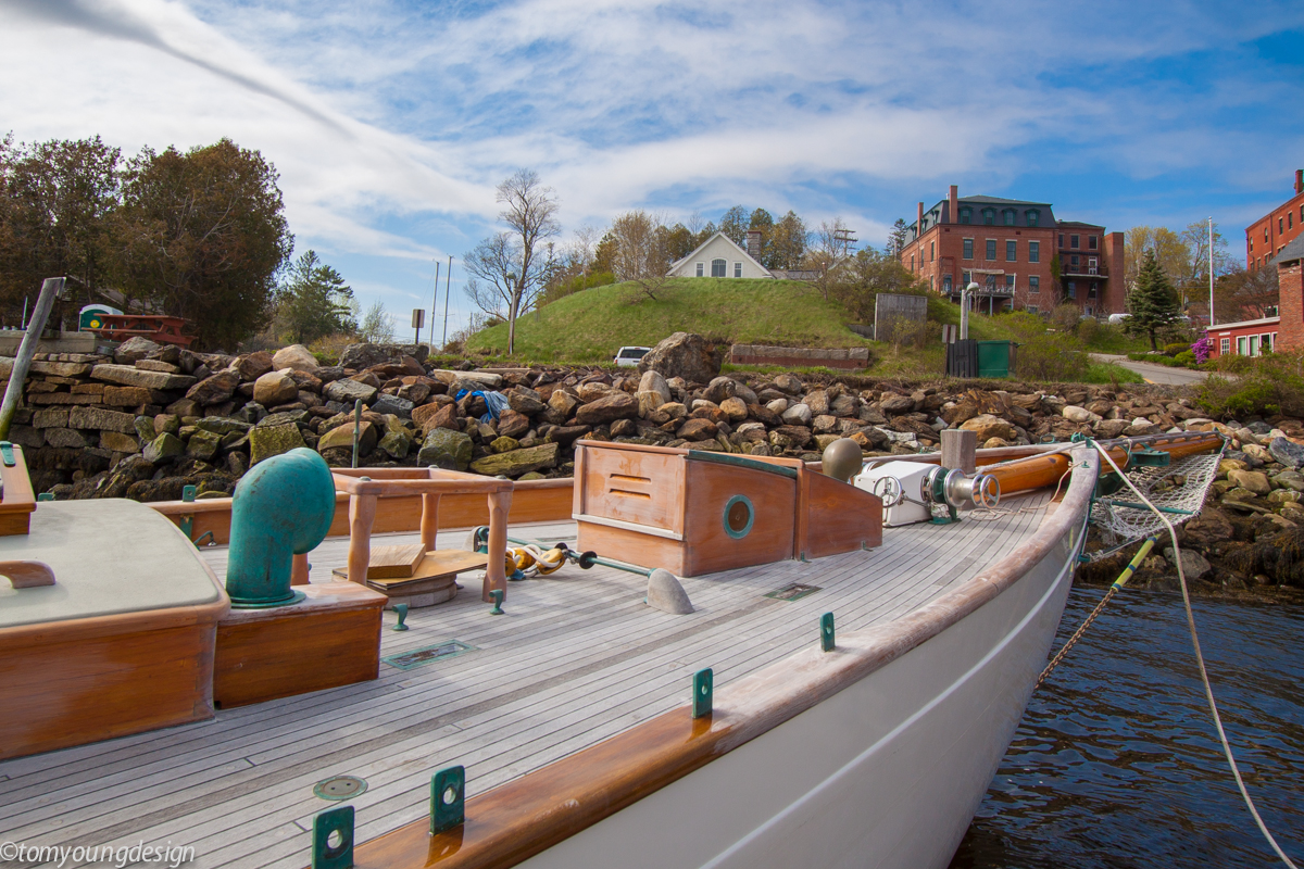

I'm refinishing the toe rails on my boat. Not a fun job. I especially hate working on my knees, on deck. So I decided to do the toerails - inside and outside - standing on staging. Being a centerboard boat helps but the toerail at the bow, if you want it at waist level, is a little high.
I use step ladders often for boat staging. The bow step is an 8'er, heavy duty. The base is wider on an 8'er making it more stable and the heavy duty rated is plenty strong enough, even for two and a plank. Plus is often the case, boats are tightly packed in.
That wasn't too bad. A couple short weekend days and one side is stripped and ready to seal. Standing comfortably it was easy to strip, scrap and sand at work bench height. We are also tucked into a hill so that complicates things as well. Saw horses, cribbing, the hill,....a few more planks

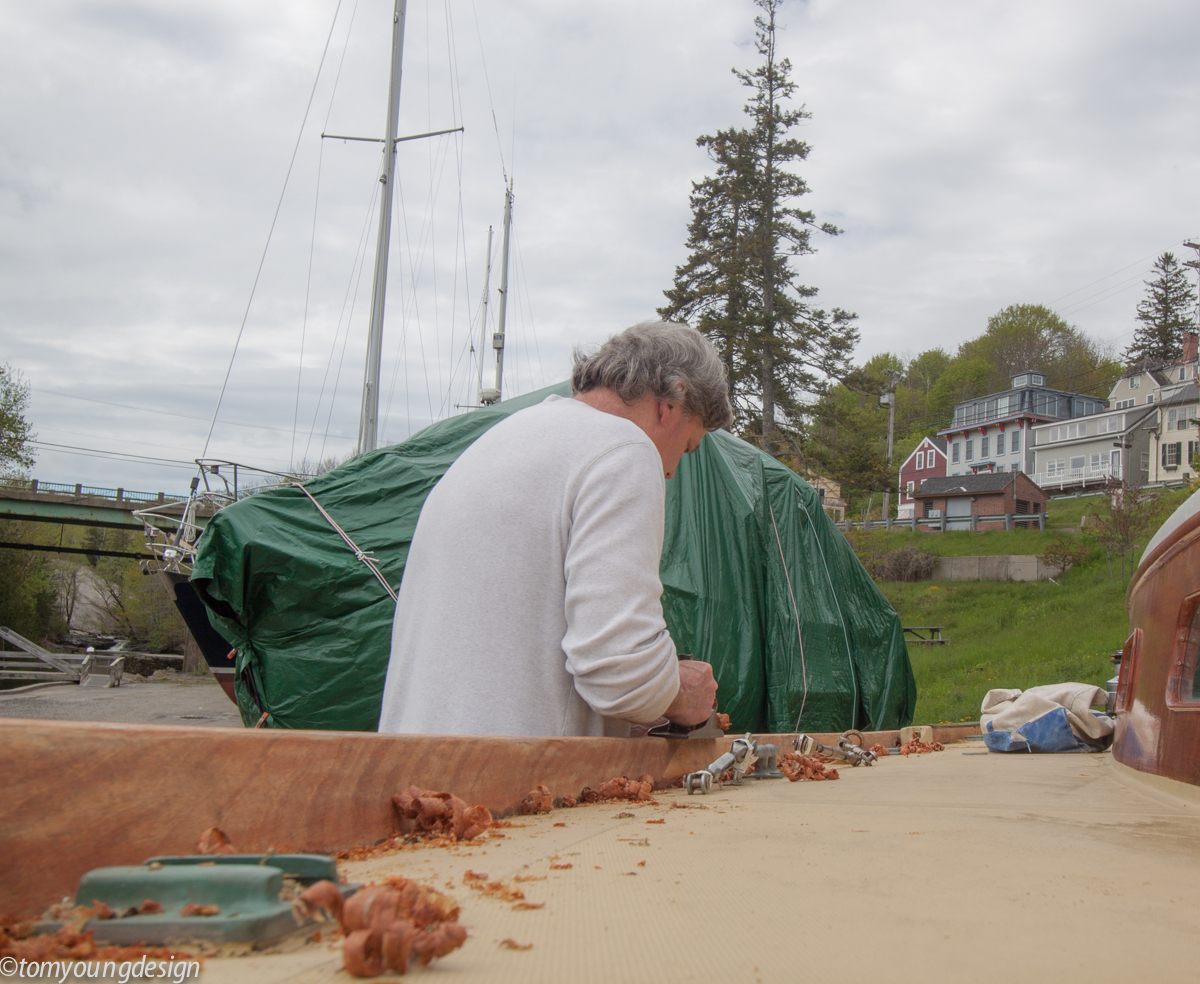

Crunch time in the boatyards. The staging puts my work at ideal level to remove the failed varnish with a heat gun and push scraper. The last of the old finish comes off with sharp carbide pull scrapers.
More than 50 years of use/abuse (feet, docks and dock lines), has worn the top of the toe rails.

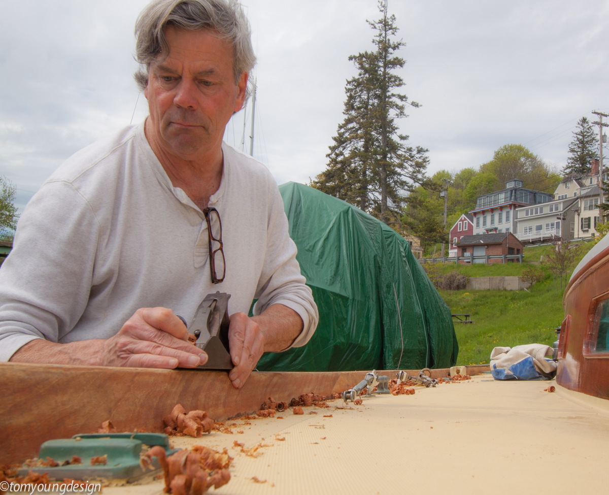

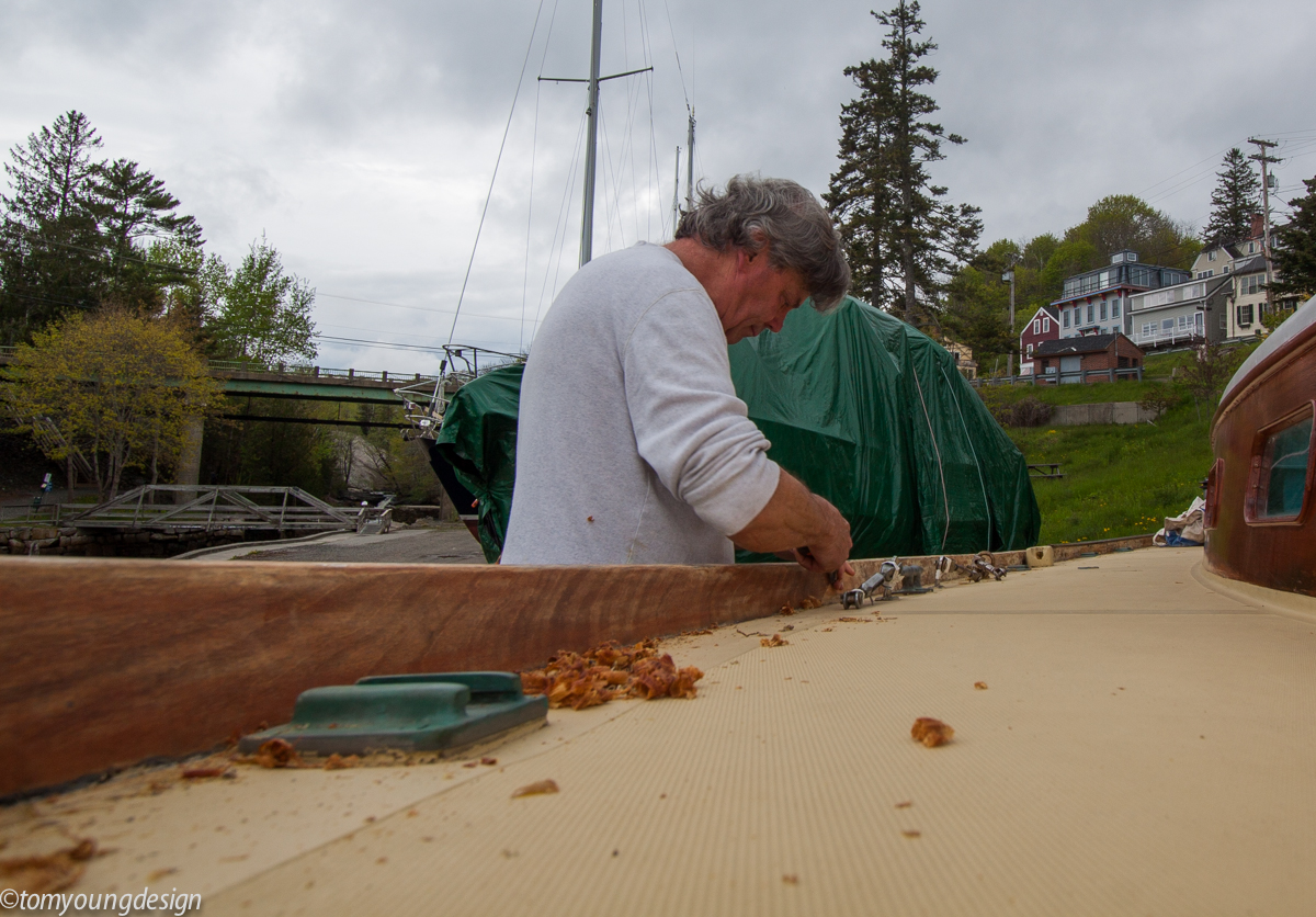

I take a sharp (long base) joiner plane to the tops. The rails - over and inch thick - stand up 2" high at the stern and gently bevel outward - to 30 degrees or so - toward the bow. They finish nearly 5" high at the stem, following the bevel of the flared bow. I shoot the original flat line back onto the tops.
Walking the joiner plane along the staging, the blade cuts a dotted line on the worn top edge. "Chic - chic -chic -chic", the plane sounds as flakes come off. Next pass is a dashed line as the shallow cuts begin to lengthen. Then finally a solid ribbon of mahogany comes off the top. Then I know the top line is true, once again.
Not much wood is sacrificed, more than a 1/16th, less than an 1/8". Then a slight round is added to the top edge with the joiner plane followed by a little work with a block plane. It's good to see the original crisp line put onto this lovely piece of mahogany, installed with through bolts every 10", 57 years ago.
This goes faster than I expect and I follow with a stout handled block sander with 80 grit paper to the flat faces of the rails. A flexible sponge wrapped in 80 grit restores the gentle round on the corners.
This too goes quickly as I can put my weight into the sandpaper. Surprisingly, I'm able to apply a filler stain as well, all in one day.

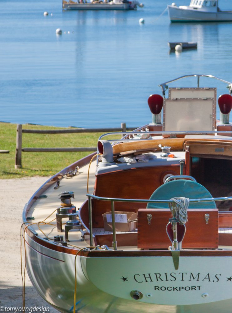

Spring 2018 commissioning, is history. I'm floating and rigged, but many boats are still launching in our harbor. It was a late, cold spring, again. Haulers and riggers tell me their traffic was (is) behind by as much as 3 weeks.
I'm allowed to work with the launch crew (I've earned it over the years). I was again awarded the fastest launch and step by the crew. Simple old boats like mine - if they stay simple - are the easiest and fastest to launch and step the rig (my wife and I step the mizzen and add the booms).

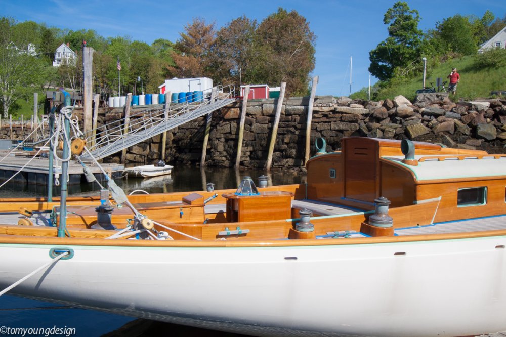

Varnishers were busy. Rebecca, a schooner from Martha's Vineyard had to wait for weather to coat.
They got their weather, it just took patience.
